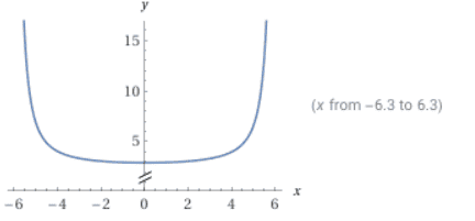

Let's define the function ##f(t) = 13^{\frac{1}{t}} + 13^{\frac{1}{13-t}}## on the interval ##t \in (0, 13)##. If we write ##x = f(6)##, ##y = f(5)##, and ##z = f(3)##, we can make a prediction. Since ##f(13-t) = f(t)##, the function is symmetric about ##t = \frac{13}{2} = 6.5##. At ##t = 0##, or rather in the limit, we have##f(0^+) = 13^{+\infty} + 13^{\frac{1}{13}} = \infty##so we can "predict" that the function is decreasing on the interval ##(0, 6.5)## and increasing on the interval ##(6.5, 13)##.
According to this prediction, we will have ##z > y > x##.To prove the prediction, it is sufficient to show that the derivative of the function is ##0## only at ##t = 6.5##. We obtain##f'(t) = \ln 13 \left[ \frac{13^{\frac{1}{13-t}}}{(13-t)^2} - \frac{13^{\frac{1}{t}}}{t^2} \right]##It can be seen that ##f'(t) = 0## for ##t = 6.5##. If ##t > 6.5##, then##t^2 > (13-t)^2 \text{ and } 13^{\frac{1}{13-t}} > 13^{\frac{1}{t}} \implies f'(t) > 0##and similarly, if ##t < 6.5##, then ##f'(t) < 0##. This completes the proof.

I haven't found one. The basic difficulty is that addition and multiplication do not match well. We can rewrite the problem as: Compare the function values of the function ##g(x)=13^{6.5 - x}+13^{6.5 + x}\, , \,0<x<6.5##
at ##x=3.5\, , \,1.5\, , \,0.5.## If we look at its graph
then we see that it is relatively flat and only slightly increasing for ##0<x\leq 3.5.## This isn't a proof, but it demonstrates that we do not have much room for rough estimations. I would guess that even series expansions have to be considered up to several terms. Maybe you can show that it is convex, but I doubt that would be easier since the basic problem with the addition gets even worse.
