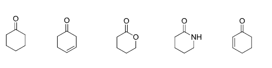

I want to put these in order of increasing wavenumber for the absorptions of the carbonyl group in an nmr spectrum
I know that the third one is the highest, the NH ketoamine is the lowest and last one is the second lowest but I'm unsure about the first. Which one has higher absorption?
Recall that IR works by exciting bonding electrons (for lack of a better term) and this causes an increase in rotational and vibrational energy, as well as bond stretching and bending. Also recall that electronegative atoms tend to shift things downfield, the more electronegative something is, the farther downfield it is shifted. So looking at what you've posted we have (from left to right) cyclohexanone, 3-cyclohexen-1-one, δ-valerolacetone, δ-valerolactam, and 2-cyclohexen-1-one (I'm not 100% on this, but I think we can call 3-cyclohexen-1-one just 3-cyclohexenone since the carbonyl carbon is always the first carbon in these molecules, maybe someone with a stronger knowledge of IUPAC nomenclature can verify this). The links are links to the NIST website with the relevant IR Spectra.
Right away you should see that the cyclic ether and cyclic amide (lactones and lactams respectively) will be shifted further than the usubstituted cyclohexanone. Typically carbonyl C=O stretches occur in the range of 1670 to 1820 or there about. Cyclohexanone has a peak at about 1710. Now valerolacetone has a broad peak about 1730 to about 1750. This is due to the electronegative oxygen atoms. Valerolactam has a forked peak at about 1710 and 1720. As you can see the more electronegative oxygen shifts this peak further than nitrogen does.
