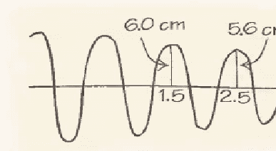

A spring with K=12N/m and an attached bob oscillates in a viscous medium.Amplitude is 6cm from equilibrium position at 1.5 s and Next amplitude of 5.6 cm occurs at 2.5s. what is its displacement at 3s and 4.5s and t=0s
x(t)=Xme^-bt/2m
x=4.16cm

e=0.133 as the ration of decay.
x(t)=xm x .133 and However, I am confused to find Xm(amplitude at 3 s) . I considered Xm=5.2cm at 3s. But, it is a false assumption.

That is not what scottdave asked. The x(t) expression should have a trigonometric factor to represent the oscillation.

You know the period. What is the general formula for a damped oscillation?

x(t)=Xme^-bt/2m here Xm is amplitude, b is damping factor

But clearly that does not produce an oscillation - unless that Xm is also a function of time.
What is the formula for an undamped SHM?
for damped Oscillation x(t)=A e^-bt/2m cos(ωt+Φ). I did not notice it properly
Here A is amplitude

Now it is a matter of plugging the known facts into that equation to determine A, b/m, ω and φ.
So you need four equations. Knowing the displacement at a given time gives you one, and knowing that this is a local extrememum gives you another. You have that for two different times, giving you four equations altogether.

Once you have determined the four constants as I described in post #16, you plug t=3 into your equation in post #15.
