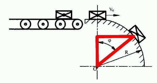

Packages, each one of them with a mass of 1kg, arrives from the moving track to a completely smooth surface of the runway, at a speed of 1 m/s, as described.
Calculate the max angle in which every package begins to veer off the runway track, if the radius of the track (R) is 0.5m

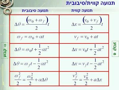

Hmm.. I need to use the last equation to the left for that, right?
Good. :)
So what is the resultant radial force in terms of phi?
But N goes to zero, so the only force playing a role is gravity. So, come to think of it, you should really ignore N in my FBD!
Nooooo, you already had the right formula in your last scan.
In your table that is the formula on the bottom right. ;)

Let's pick another triangle then. :smile:
Say one that has phi as in the following picture, and that has R as in the same picture.
We'll use a triangle that has the drawn line to the package as the diagonal side.
Another side goes straight up until it reaches the level of the package.
And the third and final side a the horizontal line on the level of the package.
Wow, thanks for the awesome effort! :smile:
I see it now, and after finding the opposite I can do Radius minus the opposite to find the value I need! Brilliant :D
But I still have only one length for this right triangle, I can't get very far from this.

Ah, but the length R and the angle phi fully determine this right-angled triangle.
Can you write down the definition of [itex]\cos(\phi)[/itex], using R for the hypotenuse?
cos phi = adjacent/radius
Hmm...so that equation and sigma Fy is the way to find the answer?
Huh? I don't think we need sigma Fy. :rolleyes:
What do you want to use sigma Fy for?
Yes, so:
[tex]adjacent = R \cos(\phi) = 0.5 \cos(\phi)[/tex]
And, as you said, delta y is R minus the adjacent. So:
[tex]\Delta y = 0.5 - 0.5 \cos(\phi)[/tex]
So we have delta y! :smile:

I guess, there is a mistake in your solution somewhere.
It is better to use symbolical solution and plug in data at the end.
From conservation of energy:
[tex]\frac {v_f^2} 2 = \frac {v_i^2} 2 + g R(1-\cos\phi)[/tex]
From centripetal force:
[tex]v_f^2=Rg\cos\phi[/tex]
[tex]Rg\cos\phi=v_i^2 + 2 g R(1-\cos\phi)[/tex]
[tex]\cos\phi=\frac{2}{3}+\frac{v_i^2}{3Rg}[/tex]
ehild
Agreed! :wink:
I just didn't want to bring extra unknowns along that might confuse the OP.
(And I was testing if the OP was sharp enough to see where the mistake is *cough*! :smile:)
Your solution looks much nicer and simpler! :cool:
