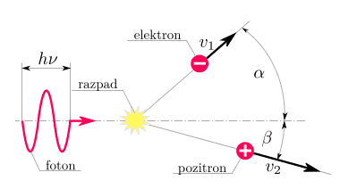

First i wanted to know if pair production really cannot happen in vacuum, so i drew a picture and used equations for conservation of energy and conservation of momentum to calculate energy of a photon ##(h \nu)## needed for pair production.
It turns out ##h\nu## is different if i calculate it out of conservation of energy or conservation of momentum. And even more! It can never be the same because equallity would mean parts ##v_1 \cos \alpha## and ##v_2 \cos \beta## should equall speed of light ##c##. Well that cannot happen.
Below is my derivation.

First of all you have to define which process you really mean. I don't understand you picture. What's "razpad"?
"Razpad" is the Slovenian word for "decay". I assumed from the context that OP was using it in the sense of particle decay, although someone fluent in both physics and English might prefer something that translated into "interaction".
vanhees71 said:
What's "razpad"?.
Oh i am sorry it means "splits". The picture shows an impossible situation which i intentionally predicted. But still. How can i show mathematically that nucleus is even needed? Where exactly does it come in so that it fixes my equations? By equations i mean these two:

Your inequality shows that the process is not possible without a nucleus.
You can look at the time-reversed process, too: With electron+positron, there is an inertial system with a fixed center of mass. This is not true for a single photon.
With a nucleus, it is a bit lengthy to calculate it in an analytic way. The general idea is that a nucleus is heavy compared to the electrons - it can gain significant momentum with little energy (##E \approx \frac{p^2}{2m}## (edit: fixed prefactor)). Therefore, you are "allowed" to ignore momentum conservation if you consider photons and electron/positron only: the nucleus will get the momentum difference.
