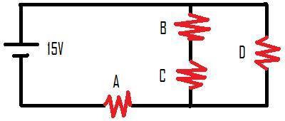

I have tried drawing it and I only need to figure out how much Power is consumed by the B bulb. My design is an attachment below
(each resistor A,B,C, and D are 2 Ohms)
And I keep getting PB = 18 which is not correct
Did I set up my circuit right?

Yes, you drew the circuit correctly. Show us how you calculated PB.
I first calculated the equivelent resistance:
(1/(2+2) + 1/2)-1 = 4/3
4/3 + 2 = 10/3
Req= 10/3
With the total resistance I found the whole circuit's current:
V=IR
I=V/R
I= 15 * 3/10= 4.5
next, I found the allocated towards the parallel circuit so I subtracted the voltage dropped from A immediately.
VA=IR
VA= 4.5*2 = 9
So, 6 volts allocated towards B,C, and D.
PB=IV
PB=V2/RB
PB= 36/2
PB=18
vela said:
4/3 + 2 = 10/3
Req= 10/3
V=IR
I=V/R
I= 15 * 3/10= 4.5
VA=IR
VA= 4.5*2 = 9
Perfect up to here.
PB=IV
PB=V2/RB
PB= 36/2
PB=18
6 volts is the drop the series combination of B and C, not across B and C individually. Your answer would be correct for the power dissipated by D since the entire 6-volt drop appears across that resistor, but with B and C, the voltage drops across the individual resistors add up to 6 volts.
vela said:
Perfect up to here.
This makes PERFECT sense! Thank you so much! I was thinking the same thing but I got confused and I forgot the square the V so instead of 4.5 I ended up with 9.
