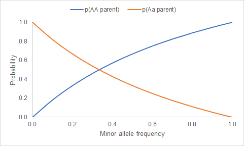

Let's approach the problem mathematically. Assume a loci with only two alleles, the major allele A and a minor allele a. What is the likelihood of a AA individual having an Aa child p(AA x __ --> Aa). For the three possible genotypes of the unknown parent, this probability is zero if the unknown parent is AA, 1/2 if the unknown parent is Aa, and 1 if the unknown parent is aa. Thus p(obs|AA parent) = (1/2)f(Aa) + f(aa), where f(Aa) is the prevalence of Aa genotypes in the population and f(aa) is the prevalence of aa genotypes in the population. Similarly, we can calculate the probability that an Aa individual has an AA child p(Aa x __ --> AA) = (1/2)f(AA) + (1/4)f(Aa).
If we assume that the population is in Hardy-Weinberg equilibrium, with minor allele fraction q for the a allele, then f(AA) = (1-q)2, f(Aa) = 2q(1-q), and f(aa) = q2, and we can simplify the expression above:
p(AA x __ --> Aa) = q
p(Aa x __ --> AA) = (1-q)/2
Thus, the likelihood of whether AA is the parent or Aa is the parent depends on the minor allele frequency. If a is more rare, it is more likely that Aa is the parent, but if a is more common, then it is more likely that AA is the parent. Applying Bayes' Law and an uninformative prior, we can get the following graph of the probability that AA is the parent vs the probability that Aa is the parent:
It seems to me that if A is as likely as a (which had been my working assumption, temporarily disregarding dominant versus recessive traits), your graph shows AA to be more likely to be the parent. You present a to-me-interesting analysis.
