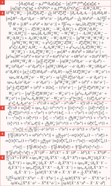

and there are still some suppressed indices …
  • Wow
  • Haha
Ladies and Gentlemen, I give you, the most beautiful equation in the world!
Really though, that's absolutely insane.
Things like this really make me feel like we're brute forcing things too hard.
