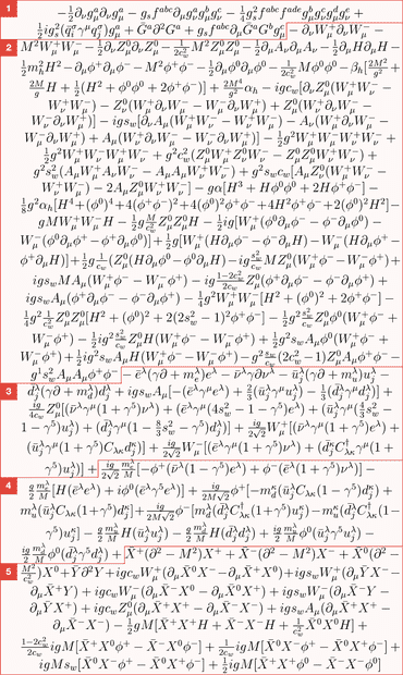

  • #49
Orodruin said:
and there are still some suppressed indices …
In the very first term (and in the whole expression), don't indices mu and nu should be on different levels like -1/2 d_\nu g_\mu^a d^\nu g^{\mu a}?
  • #50
Yes. There are however some authors that consider it so basic that they state that is obvious and subtextual. I know that Schwartz does this in his QFT book for example (it is explicitly stated in the introduction).
