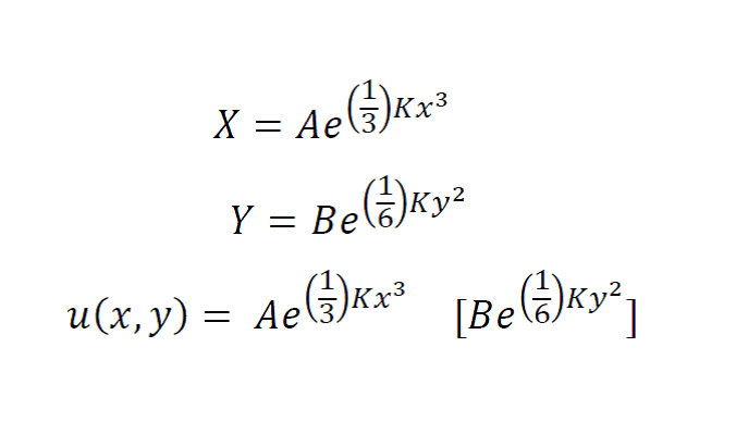

Thanks that simplified things a little. For the positive constant I solved the 2 ODE's as:
And then put them together. If I do the same for a negative constant would that cover the possible solutions (assuming I can rearrange and solve them properly)?
Thanks:D
