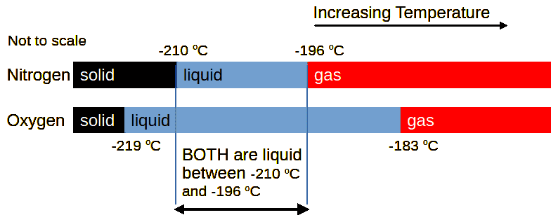

Hi @Jigneshbharati. If you are still reading, and if your son is still struggling, a diagram should help him:
Having taught for KS3 (a very long time ago) I would expect the official mark-scheme to allow an answer anywhere in the range -210 ##^\circ##C to -196 ##^\circ##C inclusive. If I were answering this (as part of a KS3 SAT test) my answer would be -200 ##^\circ##C.
