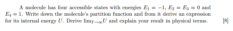

Typeset problem statement: a molecule has four accessible states with energies E1 = -1, E2 = E3 = 0 and E4 = 1; asks for the partition function, an expression for internal energy U, and the limit of U as T tends to infinity.
A molecule has 4 states of energy -1, 0,0 and 1. Find its partition function and limit of energy as T → ∞.
[tex]Z = \sum_r e^{-\beta E} = e^{-\beta} + 2 + e^{\beta}[/tex]
[tex]U = -\frac{\partial ln(Z)}{\partial \beta} = \frac{e^{-\beta} - e^{\beta}}{e^{-\beta} + 2 + e^{\beta}}[/tex]
As ##T→\infty##, ##exp(-\beta) \approx 1 - \beta## and ##exp(\beta) \approx 1 + \beta##.
Thus,
[tex]U \approx \frac{(1-\beta) - (1+\beta)}{2 + (1+\beta) + (1-\beta)} = -\frac{\beta}{2} = -\frac{1}{2kT}[/tex]
The equipartition theorem should take over with Energy = 4 * (1/2)kT = 2kT = 2/β.
But instead I'm getting -β/2.
Ammm, okay...
Your calculation is right, at least I got the same result for ##U##.
my comment about the equipartition theorem: My experiences are that you really have to master thermodynamics to completely understand this theorem. Lots of results can be "guessed" if you truly understand the concept. I was never that good at it therefore I always had to do the long calculations.
Ok, now to tell something that is actually useful:
from http://chemwiki.ucdavis.edu/Physical_Chemistry/Statistical_Mechanics/Equipartition_Theorem (Degrees of freedom):
"The law of equipartition of energy states that each quadratic term in the classical expression for the energy contributes ½kBT to the average energy."
Let's take a molecule of ideal gas for example: One molecule has in fact ##6## degrees of freedom. ##3## of them precisely describe it's position and are called coordinates (x,y,z), the other ##3## are of course components of momentum (note that momentum is quadratic in energy ##E_k=\frac{p^2}{2m}##). Each component of momentum therefore contributes ##\frac{1}{2}kT##, so the average energy of molecule of ideal gas is ##\frac{3}{2}kT##.
I guess all I am trying to say is that you have no quadratic degrees of freedom and therefore your calculation using equipartition theorem is wrong.
ps: Keep in mind that I never mastered that theorem. I hope I didn't just make a fool out of myself.
