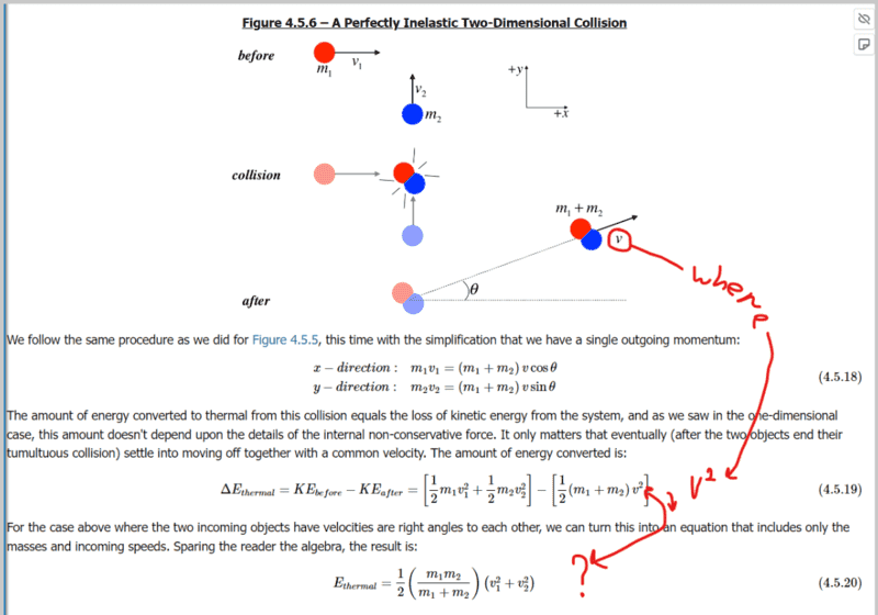

Where did "v" go?
I still don't get it where did "v" go.

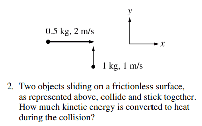

I'm trying to solve the problem that is on the second image.
Textbook figure 4.5.6, a perfectly inelastic two-dimensional collision: before, red mass m1 moves right at v1 and blue mass m2 moves up at v2; collision; after, combined mass m1 + m2 moves at angle theta with speed v. Equations 4.5.18 and 4.5.19 and 4.5.20 shown, with red annotations.

Diagram of two objects on a frictionless surface before a collision: a 0.5 kg object moving right at 2 m/s, and a 1 kg object moving up at 1 m/s, with x and y axes shown. Below is problem 2 about how much kinetic energy becomes heat.
Yes well your book doesn't show all the in between steps on how exactly it derives that result. It just states "Sparing the reader the algebra".
What is done in the in between steps (which you should try to work out by yourself, I ll just outline the steps) is that the system of equations 4.5.18 (two equations with two unknowns, the common velocity and the angle) is solved and then once you solve it and find ##v## (##v## will be a function of ##m_1,m_2, v_1,v_2##) then ##v## it is replaced in equation 4.5.19 and then after some algebra you end up with equation 4.5.20.

There's a general result (which can be derived) for energy loss in a 1 dimensional inelastic (collide and coalesce) collision: $$\Delta E= \frac{1}{2} \mu \Delta v^2$$ where ##\mu## is the reduced mass of the colliding objects and ##\Delta v## their relative velocity: $$\mu = \frac{m_1m_2}{m_1+m_2}$$It looks like there's nothing different here except that ##\Delta v## is replaced by the vector difference of the two velocities.
