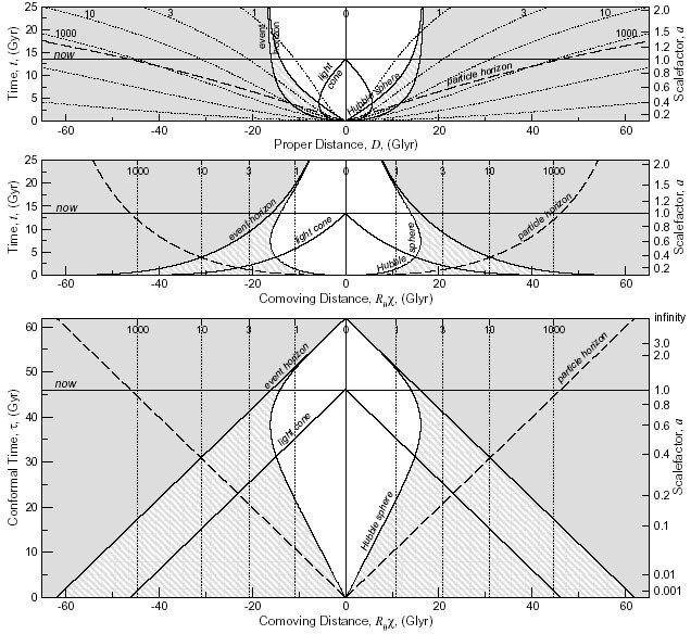

A good way to picture the teardrop shape of the lightcone with its maximum bulge, its maximum girth, at z = 1.6 is to look at the TOP PANEL
of Lineweaver Figure 1. The widest point in the lightcone comes just exactly where the Hubble radius crosses it. Hubble radius is where recession speed equals c. You may need to enlarge the top panel to see that the "hubble sphere" line crosses the lightcone curve exactly where the latter is vertical---the light cone's widest point. The lightcone curve shows the career of a photon that is trying to reach us and finally does, at the present time. If it starts earlier (before year 4 billion) it is at first swept back by expanding distance, until it reaches proper distance 5.8 Gly and then it begins to make headway towards us.

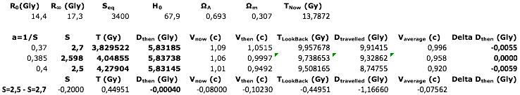

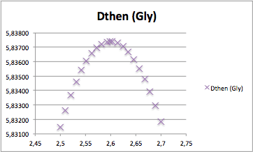

Wow :-) I have purchased the book Relativity 4 Eng. and learned to use the Cosmological Calculator. Here is a summary of understanding for the records on the initial question "what is the physical meaning of 2 identical Proper Distance at Emission time?". I have worked out calculations and a graph below.
Essentially, for photons at Dthen = 5,831, one was emitted at T=3.83 Gy and observed with S=2.7 while the other photon was emitted at T=4.28 Gy and observed with S= 2.5. The bottom line gives the difference between photon S=2.5 minus photon S=2.7. The middle line is about S=2.6 where a photon would receed at about the speed of light; that is what the plot shows with more details. Thank you again for your valuable inputs. AlephClo
