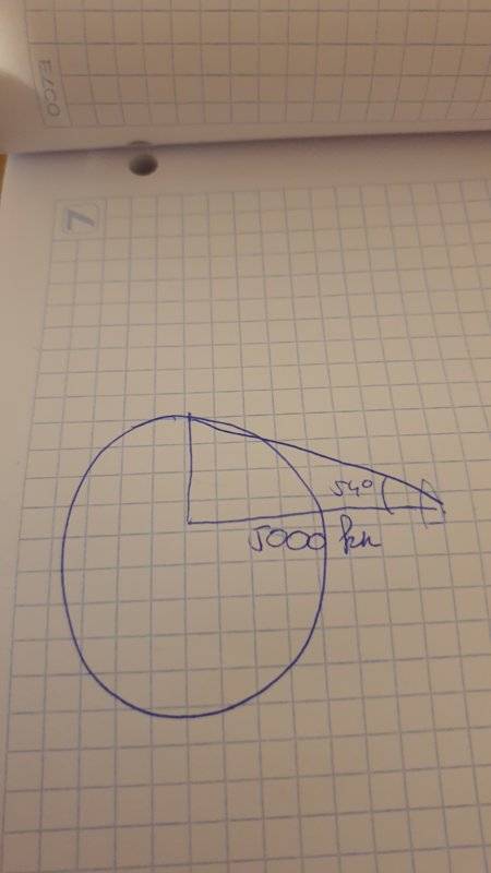

Hand-drawn diagram of a circle with its centre marked, a radius drawn horizontally labelled 5000 km, and a tangent line from a point outside the circle meeting the circle at the top, with the angle at the external point labelled 54 degrees.
Hello, first off thank you for taking the time to answer ! Sorry about this bad drawing, but in this case i imagine all i need to use is trigonometry in order to find the value of the side opposite of the angle. However,now that i know the radius i still do not know how to find the mass or the force of gravitation on that planet. I was thinking maybe dividing the force of gravity on Earth by ~5 since 74 divided by 5 is approximately the 15kgs that the astronaught weighs in orbit?

Albertus50 said:
View attachment 260311Hello, first off thank you for taking the time to answer ! Sorry about this bad drawing, but in this case i imagine all i need to use is trigonometry in order to find the value of the side opposite of the angle. However,now that i know the radius i still do not know how to find the mass or the force of gravitation on that planet. I was thinking maybe dividing the force of gravity on Earth by ~5 since 74 divided by 5 is approximately the 15kgs that the astronaught weighs in orbit?
This picture is incorrect, as you can see if you study it closely. You've drawn a ray which is the hypotenuse of a right triangle. But notice that in order to reach the far vertex of that particular triangle, your ray has to penetrate the surface of the planet.
That is not the ray that defines the horizon.
The ray with the widest angle makes a tangent with the circle. And do you recall a theorem about tangents to circles and the radius from the center to where the tangent touches?
Also my interpretation is that the 54 degrees is from top to bottom, so the angle you've drawn would be only half of that, or 27 degrees.

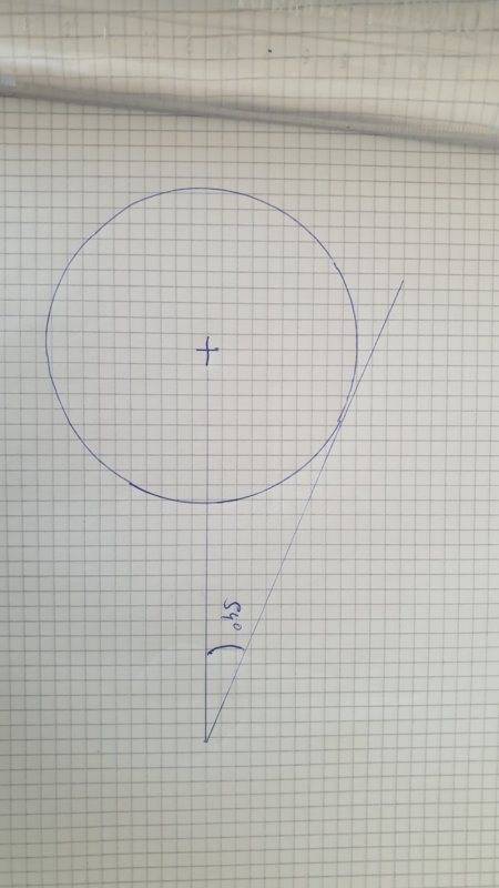

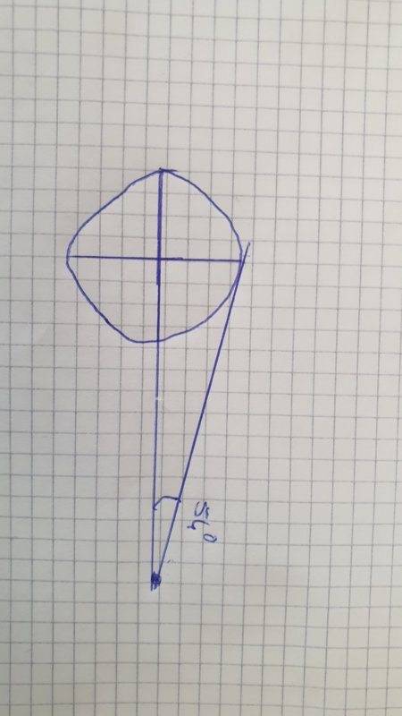

Try drawing the diagram carefully. Draw a proper circle (with the centre at the centre!) and draw a line from the shuttle to the surface. Do not let your line go through the surface of the planet. It doesn't need to be to scale, but it does need to be done carefully.

i would do it like this, this time my hypothenuse does not cross inside the planet. Should i still solve this using trigonometry?

That's better. As mentioned above, I suspect the half angle you have shown should be ##27## degrees.
(The one you have drawn looks close to ##27## degrees.)
You need to add the radius of the planet and use the key fact about a radius and a tangent to the same point on the circle.

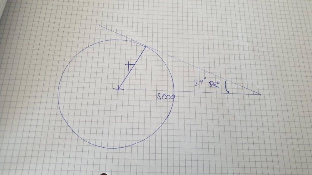

So here my radius is X, since the radius and the tangent are perpendicular, i can use trigonometry to find the radius, is that right?
  • Hand-drawn diagram on grid paper of a circle with centre marked X, a radius drawn to a point of tangency where a tangent line meets the circle, a line from the centre through the circle labelled 5000, and an angle labelled 27° 54° at a point outside the circle.
Exactly.
I get it! thank you so much for your time!
