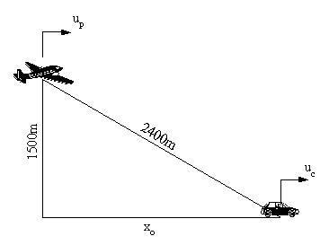

A plane traffic monitor monitors traffic on a major highway in the U.S. by flying around 1500m above the road with a constant speed of 200 Km / h. Using the radar, the pilot discovers a car thought to be traveling above the speed limit and is located 2400m from the plane and in order for the plane to stand directly above the car, itneeds to reduce its speed at a rate of 220Km/h^2. Calculate the speed of the car.
We can calculate the distance between the car and the plane using the Pythagorean Theorem, that gives us that the distance is 1,87km.

The initial distance from the plane to the car, 2400m, along with the cruising altitude of the plane, should give you the initial horizontal distance betwixt them.

XD love the pic gneill

I thought we'd moved on to that! This means you still need to find the speed of the car. Can you write the equations for the motion of the plane and car? Take the plane's initial position to be the origin (so the plane starts at distance 0 and the car at distance xo = 1873.5m).
Nice pic, but I would have interpreted the 2400 m as the horizontal distance from plane to car.
