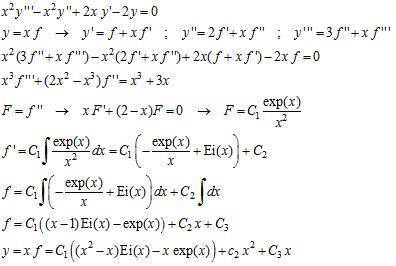

Please if anyone can help me to solve this differential equation.
Hello,
Two obvious solution of the homogeneous part of the equation are y=x and y=x². The third is a special function.
Nevertheless, particular solutions for the whole ODE can be derived :
Let y=x*f(x) and solve the ODE which unknown is f(x).
I can find that first and second obvious solution of the homogeneous part x and x^2,but how can I find the third,it is something of x^x.
Can anyone explain how to find the particular solution showing me some steps of the solution.Thank you
Can you write the special function and show me some steps how to find particular solution.Thank you
The general solution to your ODE is as follows
[itex]y(x) = -3x(x-3)\ln(x)+[(-\frac{1}{2}x^2+x)\int_{-x}^∞ \frac{\exp(-t)}{t}dt -\frac{1}{2}\exp(x)(x-1)]C_1-\frac{x^3+9}{2}+x^2C_2+xC_3[/itex]
where [itex]C_i[/itex] are arbitrary constants.

Hi !
In attachment, the solution for the homogeneous ODE.
Same method for the complete ODE.
