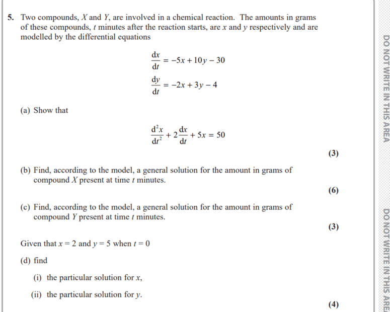

  • #37
I have read all of your comments.
I will post an image from my textbook, and would like all of your opinion on it.
Part a) is fine, just differentiate the top expression with respect to t and make the appropriate substitutions. Part b) asks you to find a general solution, so we find a particular solution (namely ##x(t)=10##) and add that onto the general solution of the inhomogeneous equation. Part c) is also straightforward (use the top equation to find ##y(t)## by differentiating ##x(t)## and making the appropriate substitution). However in part d) we are given some initial conditions and then asked to find the particular solution. Technically speaking, are the functions we found (such as ##x(t) = 10##) not also particular solutions? Clearly what makes the particular solution in part d) different to ##x(t) = 10## is that it matches the required initial conditions.
Thoughts?
My textbook calls the function ##x(t) = 10## the particular integral, and reserves the phrase particular solution for the final answer with no undetermined constants. Found a similar post, will link below. https://www.physicsforums.com/threa...ular-integral-and-particular-solution.667568/
  • #38

  • #41
No. You are asked to find the particular solution that satisfies <<conditions>>. Here the <<conditions>> (typically boundary/initial conditions) single out one of the many particular solutions.
