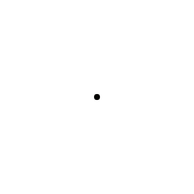

You can plot a sequence of surfaces. Here's a simple example done in Maple, where you have a sphere with perhaps a varying density indicated by a change in color. But you can't see it all at once. Not sure if it's the kind of thing you want or whether an animated gif will work here. Here goes:
Well, I guess it works.

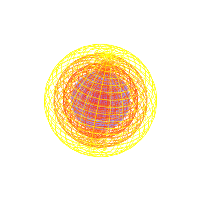

Here's another example where instead of animation I use wireframe so you can see through it somewhat. It's the same example:
Yes, that is ok. Your function is something like ##\rho(x,y,z,t)=x^2+y^2+z^2+\phi(t)##? I think it would be ok just to plot ##\rho(x,y,z,t)=1## at all times, in this case I think it would be just a fixed sphere, but in general it would be some evolving isosurface.
