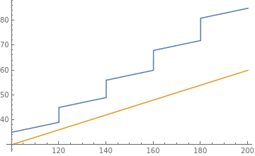

I am trying to plot two functions a(t) and b(t) that both use a common intermediate result K. In my actual code K would be a slow-ish calculation. To reuse the K across a and b, I am putting them into a single module that provides an array {a, b} to the Plot[] function. (BTW, the Evaluate[] is needed because without it, both plots come out the same color).
So far so good. But a(t) involves discretizing t to get N, and then summing over N terms, as in Total[Range[IntegerPart[t/20]]].
Now, although the plot comes out OK in this example, it displays a little error message : "Range specification in Range[IntegerPart[t/20]] does not have appropriate bounds". I am worried that this error will break my actual plot, which would be more complicated than this minimal demo, so it would be nice to get rid of the error.
And BTW, if I plot a and b separately and do a Show[Pa, Pb] then it works fine with no error -- at the cost of computing K twice as many times. Same if I Plot[{fn_a[t] , fn_ b[t],{t,0,10 }] in the usual way.

If K is a function of x then you can make K into a function that remembers its values as follows:
K[x_]:=K[x]= (* some expression involving x *)
Every time you evaluate K it will remember the result and it will simply use that result instead of recalculating it.

Brilliant!
Now the code is as simple as this:
Code:
fnA[x_]:=Total[Range[IntegerPart[x/20]]]
fnB[x_]:=.1*x
n=0 (*Evaluation counter for K *)
K[x_]:=K[x]= (n=n+1;0.2*x) (* value common to A, B *)
Plot[{ K[x]+fnA[x] , K[x]+fnB[x] } , {x,100,200}]
Style[Row[{"Evalutated 'K' ",n," times"}],20]
Line plot with x-axis from 0 to 200 and y-axis from 0 to about 85. Blue stepped curve rises with jumps at x = 120, 140, 160 and 180; orange straight line rises steadily from the origin to about 60 at x = 200.
Text output reading: Evalutated 'K' 262 times
Thanks again!
