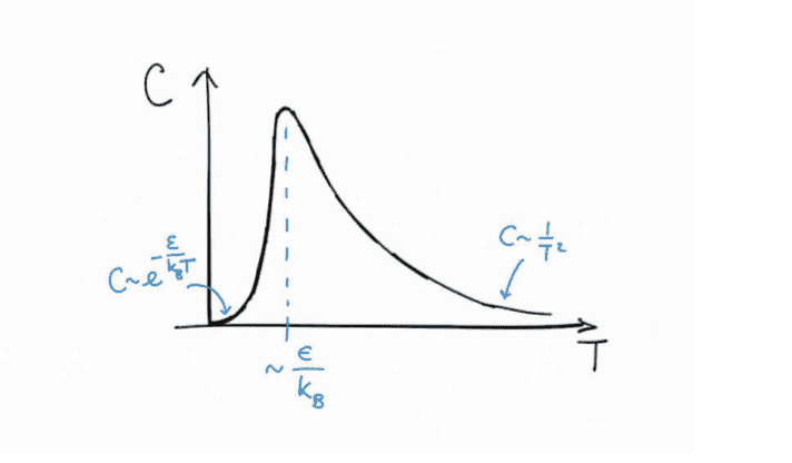

I have ##C= NK_B (\frac{\epsilon}{K_B T})^{2}e^{\frac{\epsilon}{K_B T}}\frac{1}{(e^{\frac{\epsilon}{K_BT}}+1)^2} ##
and need to sketch ##C## vs. ##T##
See above
Considering asymptotic limits I have:
##C \to e^{-\frac{\epsilon}{K_{B}T}} ## as ##T \to 0##
##C \to \frac{1}{T^{2}} ## as ##T \to \infty##
The solution is attached.
So from these limits I get the shape at these ends, and deduce there is a maximum to allow me to sketch the rest of it.
I am unsure how to deduce this maximum?
Differentiating gives quite a mess and it seems that it should be obvious to conclude the maximum is at ## \epsilon / K_{B} ##, or at least a better method to find this point? (My knowledge of graph sketching is quite poor).
Many thanks in advance.

The only suggestion I'd have is to let ##u=\frac{\epsilon}{k_\text{B}T}## and find the extremum of
$$\frac{u^2 e^u}{(1+e^u)^2}.$$ It shouldn't be that messy.

I have:
##2e^u+2+u-e^u u =0 ## , unsure of where to go now...
You'd have to solve that numerically. To get a qualitative idea of where the root lies, you can rewrite that equation as
$$e^u = \frac{u+2}{u-2}.$$ Plot graphs of the two sides of the equations and see where they intersect.
