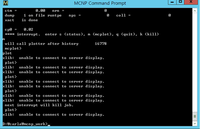

hi dears
I am trying to plot my mesh tally with no success.
Try it on vised (no tally no plot) and on promt (see photo)...
if anyone can give an insight is highly appreciated.
tks
Carla
Dear Carla
Mesh tally in MCNPX or higher versions are plotted using the gridconv first to make a dat file of your input. Then you must use Tecplot to be able to plot your mesh tally.
