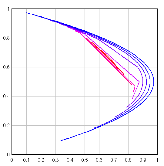

I'm going through "The Chaos Cookbook" right now, a fairly old book on chaos programming. A bit too old I'm afraid, all the programs are written in Pascal and Basic. I had been using Excel (well, Open Office Calc) to do the iterations and graphing, but I feel that the size of the programs are out growing the scope of Excel. I wrote a C++ program to create the data points for a Martin diagram of the Logistics equation (the data is here http://www.box.net/shared/kr2cz5es0g if you care).
My question is how can I get mathematica to turn these data points into a graph, and/or is there perhaps better software I should be using for something like this (The main advantage is I get mathematica for free from my university).
It might be worth adding I can, pretty much, change the format of the data from that file at will if someone thinks a different format would work better.
Thanks for your help!

After sorting your input in DPlot (www.dplot.com), the default plot you get is shown here:
If you try DPlot and have any questions please let me know at support@dplot.com.

Whoops, I overlooked the blank lines, as did DPlot. You can copy/paste the individual data sets (assuming that's what they are) or send each set to DPlot programmatically, then Edit>Swap X,Y, Edit>Sort, and Edit>Swap X,Y to restore the original order. It isn't clear if this is what you're after or not, but here's the result:

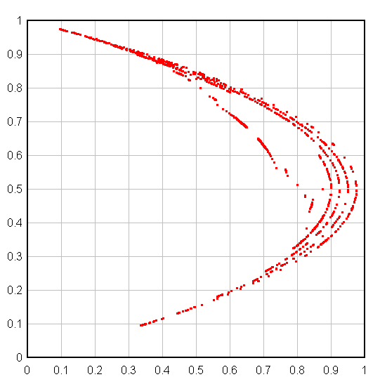

There was so much scatter in your data that I thought you must have intended the blank lines to be delineators between data sets... or something.
With a text file containing comma- or tab-separated values like yours, you can just drag the file onto the DPlot window and it will interpret it correctly. Alternatively after selecting File>Open, pick file type "D Multiple columns e.g. CSV files".
When I do that with your updated file and turn symbols on, lines off, I get:
