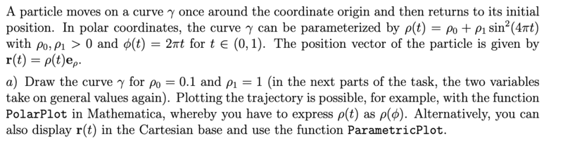

Plot the curve of ##\rho(t)=\rho_0 + \rho_1 \sin^2(4 \pi t)##
none
Hi,
Unfortunately, I am not quite sure whether I have solved/plotted the following task correctly

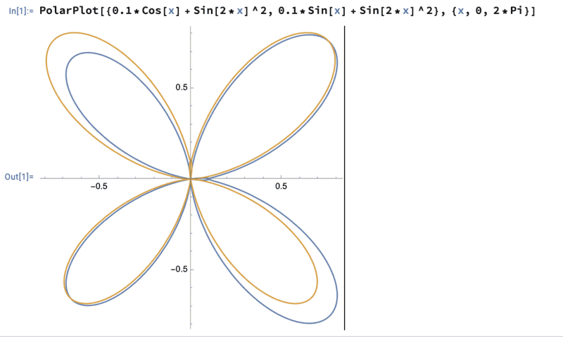

I started by resolving the expression ##\phi=2 \pi t## to t so that I can represent ##\rho(t)## with ##\rho(\phi)##
The vector ##\vec{e}_r## was written in my lecture as follows ##\vec{e}_{\rho}## , ##\vec{e}_{\rho}= \left(\begin{array}{c} \cos(\phi) \\ \sin(\phi) \end{array}\right)##
Then the position vector is ##\vec{r}(\phi)=\rho(\phi) \vec{e}_{\rho}=(\rho_0+\rho_1 \sin^2(2 \phi) ) \left(\begin{array}{c} \cos(\phi) \\ \sin(\phi) \end{array}\right)##
Then I plotted this expression using Mathematica from ##0## to ##2 \pi##
Is that correct? Because doesn't the two different colors mean that I got the trajectory for two different particles instead of just one?
Note that the expression ##\rho = 0.1 + \sin^2(4\pi t)## is always greater than or equal to 0.1. So, the trajectory never gets closer than 0.1 to the origin.
The format for Mathematica's PolarPlot is
Here, ##r## is just your ##\rho## expressed as a function of ##\phi##, but without the ##\vec{e}_{\rho}= \left(\begin{array}{c} \cos(\phi) \\ \sin(\phi) \end{array}\right)##. By putting in ##\vec{e}_{\rho}= \left(\begin{array}{c} \cos(\phi) \\ \sin(\phi) \end{array}\right)##, you are essentially going to Cartesian coordinates where the x and y components are expressed in terms of the parameter ##\phi##. In that case, you could use Mathematica's ParametricPlot. However, I think using PolarPlot is simpler here.
In addition to what @TSny said, can I add this.
Note that ##(\rho_0+\rho_1 \sin^2(2 \phi))## is a scalar quantity. So
##(\rho_0+\rho_1 \sin^2(2 \phi) )\left(\begin{array}{c} \cos(\phi) \\ \sin(\phi) \end{array}\right)##
is equal to
## \left(\begin{array}{c} \rho_0\cos(\phi)+\rho_1 \sin^2(2 \phi)\cos(\phi) \\ \rho_0\sin(\phi)+\rho_1 \sin^2(2 \phi)\sin(\phi) \end{array}\right)##
This doesn't match what you entered in Mathematica.
You might want practise/check by plotting a few simple curves of known shapes.

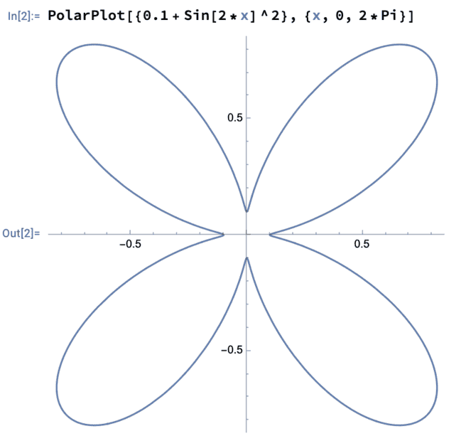

I have now redone the plot and got the following:
Looks good.
