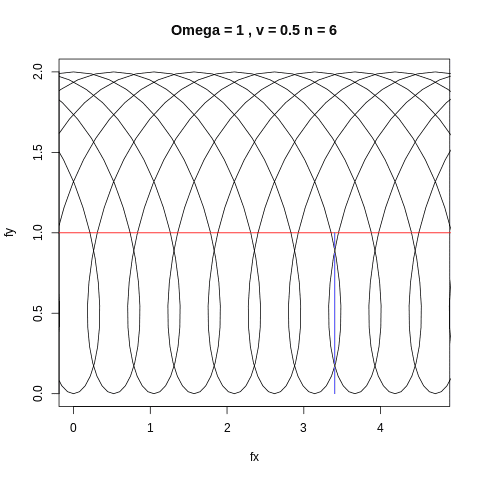

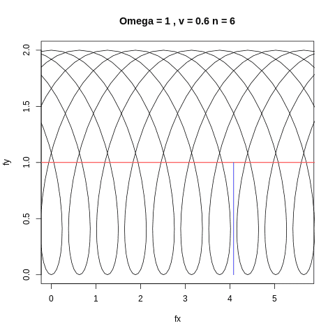

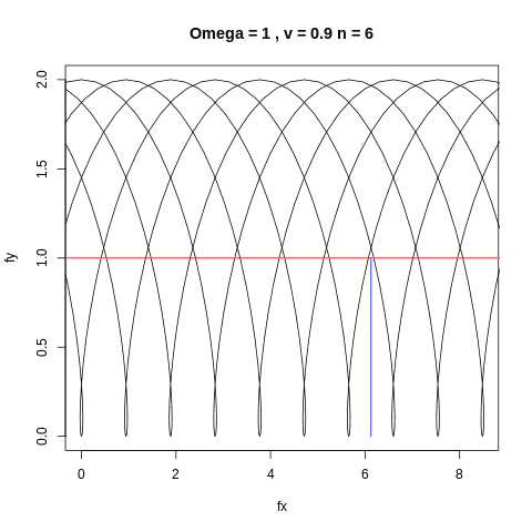

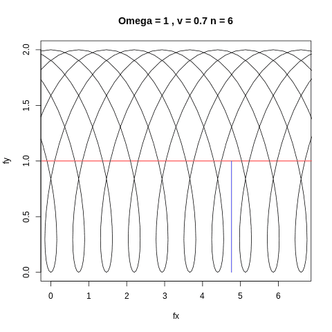

But if we allow ##v<\omega##, we can get a solution with ##n=6##. I attach graphs that show solutions for ##n=6## and ##v/\omega## ranging from 0.6 to 0.9. The blue vertical stick is the obstacle, and we can see it is cleared by all trajectories. As we reduce the ratio ##v/\omega##, the arched curves get steeper, giving more headroom to fit the blue stick obstacle. But the loops at the bottom, which are where the lowest points move backwards, also get fatter. Once two consecutive lower loops touch, we can no longer place an obstacle between them. That happens when the ratio is 0.5.
