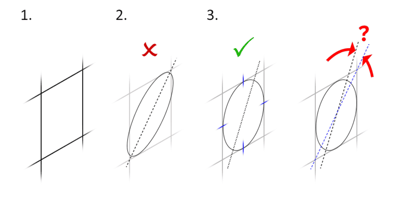

This comes up in a drafting and illustration contexts. It's a mix of 2D and 3D geometry.

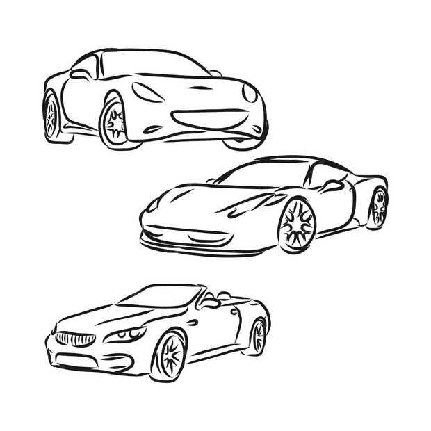

Since I was about twelve and first learning to draw mag wheels on racecars, I've been inscribing circles inside squares.
Three black line-drawing sketches of sports cars in three-quarter view: a convertible at the bottom, a coupe in the middle, and a car with spoked alloy wheels at the top.
(Not mine. Stolen off Google)
I noticed right away that it is not as simple as it might seem.
To replicate this, we start with a square, viewed obliquely (1).

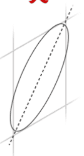

Naively inscribing an ellipse into it with its axes aligned to the square's diagonal will result in the incorrect orientation that looks terrible (2).
To seat the circle correctly in the square, the circle must tangentially touch the centre points of all four sides of the square (3). This new shape is also an ellipse, but its major/minor axes are at an angle to the construction lines of the square.
Four-panel diagram of an oblique square with an inscribed ellipse: 1, bare parallelogram; 2, ellipse with a red cross, its axis along the diagonal; 3, ellipse with a green check, touching side midpoints marked in blue; 4, dashed and dotted axes compared with a red question mark.
My question is: is there a logic to the relationship between the ellipse's actual axes and the square's construction lines?

For reference, this is how we were taught to do it in High School Mechanical Drafting. Four circular arcs.
It's still a hack, but a more serviceable one.
Diagram of a red ellipse inscribed in an oblique parallelogram, with four blue circular arcs drawn tangent to it at its ends and four blue cross markers at the corner points, over faint construction lines.
I think the projection from [itex](x,y,z)[/itex] space to the 2D [itex](X,Y)[/itex] space of the paper is [tex]\begin{split}<br /> X &= x + y \cos \theta \\<br /> Y &= z + y \sin \theta\end{split}[/tex] where [itex]\theta[/itex] is the angle between the horizontal ([itex]X[/itex]) axis and the image of the [itex]y[/itex]-axis. Then the image of the circle [itex](y - \frac12)^2 + (z - \frac12)^2 = 1[/itex], [itex]x = 0[/itex] is [tex] (X\sec\theta - \tfrac12)^2 + (Y - X\tan\theta - \tfrac12)^2 = 1[/tex] and setting [itex](X,Y) = (u + \tfrac12\cos\theta, v + \tfrac12 (1 + \sin\theta))[/itex] reduces this to [tex] u^2\sec^2 \theta + (v - u\tan\theta)^2 = \frac12[/tex] or [tex] \begin{pmatrix}u & v \end{pmatrix}<br /> \begin{pmatrix} 2(\sec^2\theta + \tan^2\theta) & - 2\tan\theta \\ - 2\tan\theta & 2 \end{pmatrix}<br /> \begin{pmatrix} u \\ v \end{pmatrix} = 1.[/tex] If [itex]\lambda_1 \geq \lambda_2 > 0[/itex] are the eigenvalues of this matrix then [itex]1/\sqrt{\lambda_2}[/itex] and [itex]1/\sqrt{\lambda_1}[/itex] are respectively the lengths of the semi-major and semi-minor axes, and the corresponding eigenvectors (which are orthogonal, since the matrix is symmetric) show how the axes of the ellipse are rotated relative to the [itex](u,v)[/itex] axes (which are parallel to the [itex](X,Y)[/itex] axes).

Yes. A template is certainly a way of making a true ellipse.
But note, it does not solve the problem of getting the angle right, which is the more primary focus of this thread.
In fact, arguably, it makes the problem potentially worse, because those templates invariably have the major/minor axes marked, and it's very tempting for a student to line the axes up to the diagonals of the square, as in figure 2. in the OP:
Ellipse drawn on a grid of oblique parallel lines, with a dashed line running through its centre at an angle and a red X at the top right corner of the ellipse's bounding area.
The same student might be tempted to shove the pencil into his nose, as well, but that's not a valid argument against pencils or templates. As I recall, there are some templates with different shaped ellipses with some fatter and some thinner.
Where the idea of “inscribing an ellipse into it with its axes aligned to the square's diagonal” comes from?
