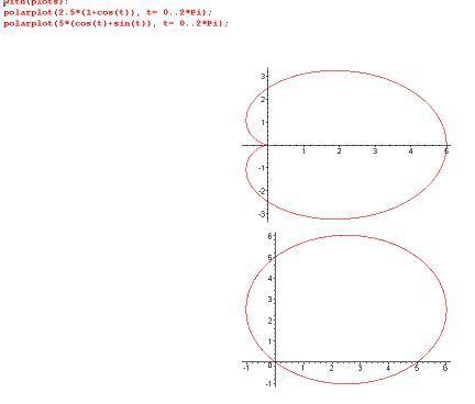

1. You need to look at how the plot is going to look like. For values of theta= 0..2Pi plot r. e.g. If r= 1, (here there is no theta) but the plot is a circle of rad=1.
Polar plots are difficuit to plot so I would suggest polarplot function in Maple
2. After looking at the plot, I see that point (a/2,0) is point (a/2,0) on the x-y axis.
See attached.

You're right. You cannot have any clue of the range by just looking at the formula. You have to plot it. That's the only way. Plotting polar graphs is hard, so I suggest use of a software such as Matlab or Maple which will give you some insight initially.
You don't really need to do a very accurate graph. Since sine and cosine are periodic with period [itex]2\pi[/itex] You can "check" submultiples of that.
The first one, [itex]r= a(1+ cos(\theta)), is particularly easy since r is never negative (assuming a> 0). Since a distance is always positive, the graph when r< 0 is interpreted as "going the other way", [itex]\theta+ \pi[/itex] and that can confuse things. When [itex]\theta= 0[/itex], r= 2a. When [itex]\theta= [itex]\pi/2[/itex], r= a, when [itex]\theta= \pi[/itex], r= 0, when [itex]\theta= 3\pi/2[/itex], r= a, and when [itex]\theta= 2\pi[/itex], r= 2a again. After that, it traces the graph over again. In order to go around the graph a single time, [itex]\theta[/itex] can go from 0 to [itex]2\pi[/itex].<br /> <br /> For the second one, [itex]r=a(cos(\theta)+sin(\theta))[/itex], you need to be more careful.[/itex][/itex]

If [itex]r= a(cos(\theta)+ sin(\theta))= acos(\theta)+ asin(\theta)[/itex], then, multiplying both sides by r, [itex]r^2= arcos(\theta)+ arsin(\theta)[/itex] or
[itex]x^2+ y^2= ax+ ay[/itex] so [itex]x^2- ax+ y^2- y^2= 0[/itex]
Completing the square, [itex]x^2- ax+ a^2/4+ y^2- ay+ a^2/4= a^2/2[/itex] so [itex](x-a/2)^2+ (y-a/2)^2= a^2/2[/itex].
The graph is a circle with center at (a/2, a/2) and radius [itex]a/\sqrt{2}[/itex], not two different "fields".
