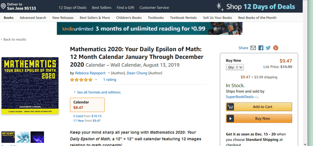

I used to buy math puzzle calendars every year. My Google-foo is failing me right now, but they had a math puzzle for every day whose answer was the date. The challenge was to figure out how to work the problem to get the right answer (the proverbial "show your work").
Now I'm inspired to purchase one for 2020 to post outside my cubicle at work. It's a great conversation starter... :smile:
Just bought this one with my Amazon account. Hopefully it's the same series that I used to get every year. :smile:

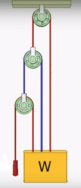

After they finish mechanics with all the standard problems in it, I like to show them the attached photo and ask them how much force I need to pull down with to make the mass go up.
