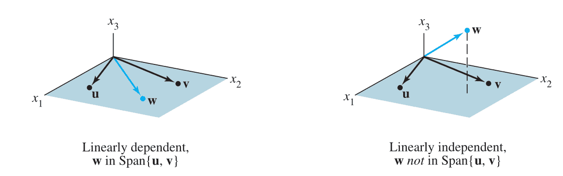

Because of this:
Basically, if $\textbf{a}_3$ isn't in span$ \{\textbf{a}_1, \textbf{a}_2\}$, then it is linearly independent of the other vectors.
  • Two side-by-side 3D diagrams of vectors u, v and w in a plane through the origin on axes x1, x2, x3. Left, labelled Linearly dependent, w in Span{u, v}: w lies in the shaded plane. Right, labelled Linearly independent, w not in Span{u, v}: w lies above the plane, off it.
Yes, $\mathbf{a}_3\notin\operatorname{Span}\{\mathbf{a}_1,\mathbf{a}_2\}$ implies that $\{\mathbf{a}_1,\mathbf{a}_2,\mathbf{a}_3\}$ are linearly independent. Therefore, the row echelon form should also have three linearly independent columns. However, possibility 2 has only 2 linearly independent columns, so it is not, in fact, a possibility.
BTW, can you clarify what they are referring to when they say $\textbf{w}$ not in span{$\textbf{u,v}$} is linearly independent? According to their graph, $\textbf{u,v}$ are linearly dependent. So why are they implying that {$\textbf{u,v,w}$} is linearly independent?
The claim that allows deducing $\{\mathbf{a}_1,\mathbf{a}_2,\mathbf{a}_3\}$ is linearly independent under the assumptions of post #1 is the claim in https://driven2services.com/staging/mh/index.php?threads/13869/. Note that it is incorrect to say "$\mathbf{w}$ is linearly independent". Only a set of vectors (even if the set contains one vector) can be linearly dependent.
What you just said doesn't exactly answer the specific question I was asking. I'm trying to get clarification on what they mean when they say that $\textbf{w} \notin \text{ span } \{\textbf{u,v}\}$ is linearly independent. Are they saying that the set $\{\textbf{u,w,v}\}$ is linearly independent?
