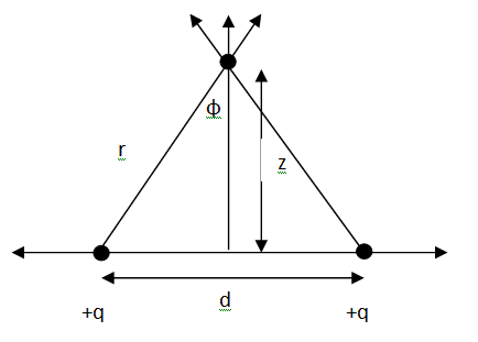

I've been working on this problem and I cannot find out where I am making a mistake.
Two charges, each with a value of +q, are placed a distance d apart on the x-axis. Find the potential at a point P a distance z above the x-axis on the z-axis
The figure below shows the physics system:
Diagram of two +q charges on the horizontal axis separated by distance d, with a point above the midpoint at height z, showing distance r and angle φ to the upper point.

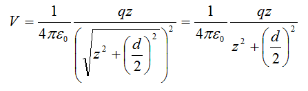

Putting everything together we get:
Equation for potential V on the z-axis from two charges: V = (1/(4 pi epsilon_0)) times qz over the square root of (sqrt(z^2 + (d/2)^2)) squared, equals (1/(4 pi epsilon_0)) times qz over (z^2 + (d/2)^2) squared.

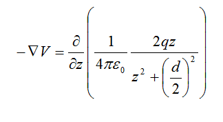

This means that the Electric Field at the same point is (I realize the forget the minus sign just now):
Equation: negative gradient of V equals the partial derivative with respect to z of 1/(4 pi epsilon_0) times 2qz/(z^2 + (d/2)^2).
Which when solved give:
Equation for the electric field E = (2q / 4πε₀) times a fraction: numerator ((d/2)² − z²), denominator (z² + (d/2)²) squared.

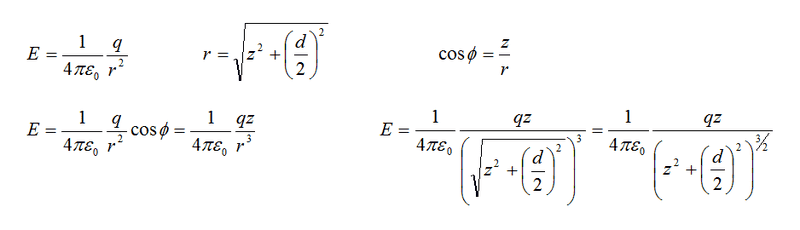

Now, using the same figure, but instead of solving for the potential, we solve for the Electric Field, we find:
Handwritten-style derivation of an electric field on the axis of a point charge: E = 1/(4πε0) q/r², r = √(z² + (d/2)²), cos φ = z/r, E = 1/(4πε0) qz/r³, and E = 1/(4πε0) qz/(z² + (d/2)²)^(3/2).
The above uses the same line of thinking, and this gives a total value of the Electric Field to be:
Formula for the electric field E = (1/(4πε₀)) · 2qz / (z² + (d/2)²)^(3/2), shown on a yellow background.
The problem is that the book says that the potential I calculated above is wrong, and that the value should be:
Equation for the potential V at a point on the z-axis: V = (1/(4πε0)) · 2q / sqrt(z² + (d/2)²).
When you calculate the value of the Electric Field from this, you get the same answer as the value I just calculated.
So, what did I do wrong in my calculation of the potential? The error seems to steam from the part where I calculated the z-component of one of the charges using cosine, but I can't see why that is incorrect.

Just remember that potential is not a vector, but is a scalar. You don't add scalars vectorially.

Remember, potential does not have a direction since it is a scalar and not a vector. There will be a force, or equivalently an electric field (which is force per unit charge) in the direction you say.
If potential is referenced to infinity, then the work done to bring a charge from infinity to any finite point on the z axis is clearly zero. Why, because you can chose the z axis itself as the path, and it's clear that the dot product of the electric field and the path is always zero. The x-component of electric field (and force) is orthogonal to the chosen path. The fact that electric fields are conservative tells you that any other path will yield the same value.
