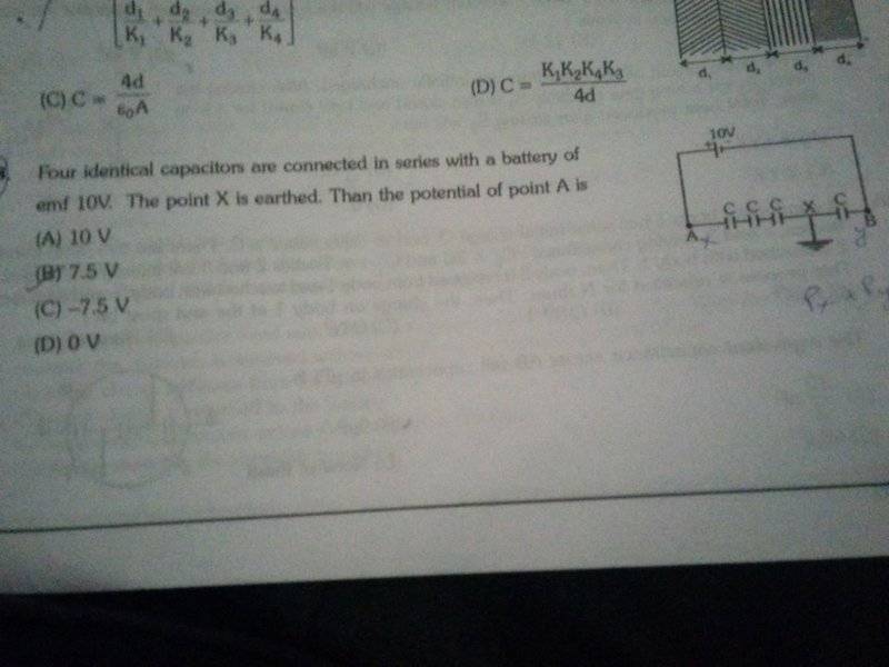

AbhinavJ said:
https://docs.google.com/file/d/0B0FIIKckKOcKM1FmXzJkYWJiZ2c/edit?usp=docslist_api
Shouldn't the potential be 10 as it is directly connected to the battery?
Potential is assumed w.r.t some reference called 'ground' which is assumed to be at 0V. In your circuit, point x is at 0V and not the -ve terminal of the battery. So, if you say A is at 10V, that means -ve terminal of the battery is earthed (which is not). So, taking x as reference, A is at 7.5 V and the potential distribution from A to B is not 10V to 0V ..its actually 7.5V to -2.5V..

cnh1995 said:
PD between A and B is 10V and voltage across each capacitor will be 2.5V (equal). So, between X and A, there are 3 capacitors. So, VAX is 7.5V with x at 0V potential. This means, A is at 7.5V.

I understand that. What I don't understand is if this is any different than placing the ground at the point X in OP's picture.
If you remove the 4th capacitor, automatically point x (ground) will be connected to the -ve terminal of the battery. So, A will now be at 10V instead of 7.5V..
Once the ground is placed at point X, why does it matter that there is a capacitor between it and the -ve terminal? Aren't they both grounded?
No they aren't..Ground is just a reference point..It can be anywhere in the circuit.. Battery neither knows nor cares where you place the ground. It will just establish a 10V pd between A and B. How to "see" the 10V path is decided by the ground. If ground is at B, then it will be
10V(point A)---7.5V---5V---2.5V(point X)---0V(point B). In the problem, X is assumed to be 0V. So, the 10V path is
7.5V(A)-5V-2.5V-0V(X)- -2.5V(B)..
Ok. I think I've got it now. My confusion was stemming from a misunderstanding of what it means to have a grounded point in a circuit. Thanks. :biggrin:
