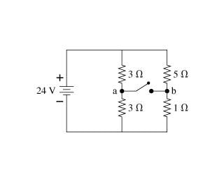

1. What is the potential difference DeltaVab between points a and b when the switch is open? Closed?
2. DeltaV = IR
3. I solved I for the battery, which is 8A. What do I use for my R value to solve for DeltaV between a and b, though? I tried, for example, DeltaV = IR = 8A*6ohms = 48V. I guess I'm confused as to what I use for R to calculate the potential at each point, which are the values I use to get my answer. Could someone explain this to me conceptually? For the potential at A, for example, I tried multiplying the current (8A) by 3ohms because the current flows through that 3ohm resistor to get to point A...

3+3=6, 1+5=6. Then, inverse of [(1/6)+(1/6)] = 3. 24/3=8A.
It's correct.
The voltage across the bottom left resistor = the supply voltage times 3 divided by (the sum of the two series left resistors) .
So it is 24 * 3 / (3 + 3) volts.

The voltage across the bottom right resistor = the supply voltage times 1 divided by (the sum of the two series right resistors) .
So, it is 24 * 1 / (5 +1 ) volts.
Then, what is the voltage between the points a and b since the bottoms of these resistors are joined?

Are you saying the voltage difference is 12V - 4V = 8V? Also, why do we care about the bottom left and right resistors specifically, since the current flows through the top two resistors to get to points a and b before reaching the bottom two resistors?

Yes, that is right.
This is just two voltage dividers.
In each voltage divider the voltage across each lower resistor is equal to (the resistance of that resistor divided by the total resistance) times the supply voltage.
You could say the current in the left two resistors is 24 V / 6 ohms = 4 amps, so the voltage across the lower resistor is 4 amps * 3 ohms or 12 volts. (Ohm's Law)
Then the current in the right side is 24 volts / 6 ohms = 4 amps. So, the voltage across the 1 ohm resistor is 4 amps * 1 ohm or 4 volts.
So, the difference in voltage at a - b is 8 volts.
a is at +12 volts relative to the negative supply and b is at +4 volts relative to the negative supply.
The first method is much quicker, though.

Now, what is deltaV between points a and b when the switch is closed? In this case, the top two (3 and 5 ohm) resistors are in parallel, as are the bottom two (3 and 1 ohm). The equivalent resistor for each of those pairs are in series with one another, so the current must be the same into and out of them. Solving I for the top two resistors:
[(1/3)+(1/5)]-1=1.875.
I = V/R = 24V / 1.875ohm = 12.8A
Then, V for point a: V = IR = (12.8A)(3ohm) = 38.4V
for point b: V = (12.8A)(1ohm) = 12.8V
deltaV = 25.6 V... is this correct?
Also, in solving for a and b, I used the resistance of the bottom two resistors. If I use the two, I get a deltaV of the same magnitude but opposite sign (-25.6V). What does this mean?
EDIT: turns out 25.6V is incorrect...?
When the switch is closed, the voltage between a and b is zero.
The switch has zero resistance so any current flowing in it cannot produce a voltage across it.

I think you were trying to use Thevenin's Theorem to work it out. However if you did, you would have the two 3 ohm resistors in parallel and the 5 and 1 ohm resistors in parallel and then put these in series with the 8 volts you worked out earlier.
It is not possible to develop 38.4 volts or 25.6 volts anywhere in a circuit that only has 24 volts as a supply and only resistors in the circuit.
So, this should give you a clue that something is wrong.
