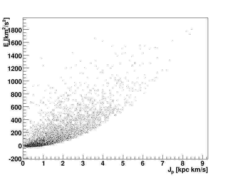

In principle I would like to see a lindblad plot of all dark matter particles in my dark matter halo. This means a plot with total energy vs. angular momentum. To calculate the total energy I need the potential to calculate the potential energy.
My question is therefore whether
E = 1/2*m*v^2 - grav_const*m*M(r)/r
is the correct formula for the total energy. M(r) is the mass within r (radius of the DM particle) and m is the mass of the particle and v its velocity.
Of course a spherical symmetric DM halo is not 100% realistic but this is just a model (first I have to understand the simple case).
I attached a plot which I get with the formula explained above... the Y axis is total energy/mass of the DM particle and the x-axis is total angular momentum/mass of the DM particle
Actually I expected to have negative energies for the particles? But for almost all particles the kinetic energy is much larger than the potential energy what means in my understanding that this particles will leave the halo? What can't be because the halo is stable...

Not quite, the mass of the Halo appearing in your formulas should not have a variable r. That is to say, even if *at this instant* the shell theorem tells you the gravitational attraction of the particle to the halo depends on it's radial position, if you are thinking about whether the particle is bound you need to consider that it is moving, hence it's r co-ordinate is changing.
The mass of the halo needs to be fixed, and there is no one right way to do this. Usually, as I say, the mass is taken to be that within the virial radius, but there is no one right way to define this. It looks like you are working with an N-body simulation snapshot? There are a lot of tools out there for analysing halo's from N-body shots, so you could look to see if there is something already available to do what you want to do?

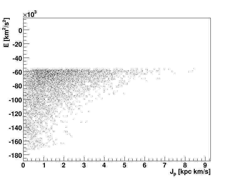

I thought because the force within r (position of the particle) is not zero and outside r it is zero I have two different contributions to the potential. Outside it should be constant because the gradient of the potential (=force) has to be zero and within r it should depend on r...
If I use the mass of the whole halo instead of M(r) (I used your definition of the viral radius) then I get negative total energies, but because of my argumentations above I am not sure whether this is correct... (remember I want to calculate the energy of one DM particle not of the whole halo)
E = 1/2*m*v^2 - grav_const*m*M(r_viral)/r

At any instant yes, but you are not interested in the instantaneous force on a particle, you want to know whether the particle is bound, so you need to consider the total mass of the halo. Think about it in terms of escape velocity. By your thinking, the escape velocity of a particle at r=0 is zero, which is clearly not the case. In fact the escape velocity does not depend on the instantaneous position of any given particle, it is a property of the whole object (assuming spherical symmetry).

Yep, negative energy means that a particle is bound. I'm not necessarily saying your plot is 100% correct (I'm not saying it's wrong either) but it is true that bound particles should have negative energy, and therefore you plot implies the particles are all bound. The large gap in energy between your highest energy particles and zero is somewhat odd. The problem is that you haven't given us much information. Where have you got these numbers from? Has someone given you the details of a Halo, derived from a simulation? If so then the method that they used to define what is and isn't part of the Halo should be considered in your analysis. You need to use the same definition of the virial radius as they have, otherwise your results will not mean very much.

ok I had a chat to my prof and he told me that the potential should go with ln(r) so the equation we are using is wrong...:-(
