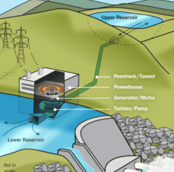

If you're willing to use liquid mass rather than solid, we already have devices that do that at scale. We call them pumped hydro. They are roughly 80% efficient.
There are people working on this concept, with pressurized water lifting a huge weight up and down, and then running through a turbine, similar to pumped hydro, but without the large footprint/ecological concerns:
https://heindl-energy.com/
I think what you guys had calculated is in the ballpark, I remember about 7 million tons or so. Obviously a huge undertaking but as you can see from the link above, people are taking it seriously. There are also some smaller modular technologies using automated cranes.
