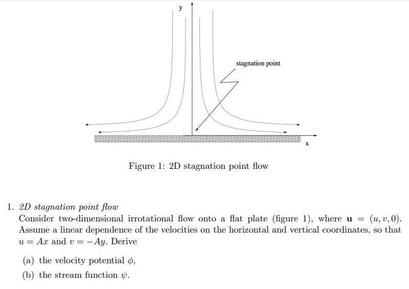

Find the potential function around a stagnation point for a perfect incompressible fluid.
Far from the stagnation point at x = 0 (##y = y_0 >> 1##), the vertical velocity is ##u_0 \hat{y}##

Here is a scheme of the problem.
Your sketch suggests thast [itex]y = 0[/itex] is a boundary of the domain. If it is, then you have the condition that [itex]\frac{\partial \phi}{\partial y}[/itex] vanishes there. It is also unclear to me whether the boundary condition as [itex]y \to \infty[/itex] applies only at [itex]x = 0[/itex] or applies everywhere. If the latter, then you could work in the inertial frame in which the fluid is stationary at infinity and has velocity [itex]u_0 \hat{y}[/itex] at the origin.

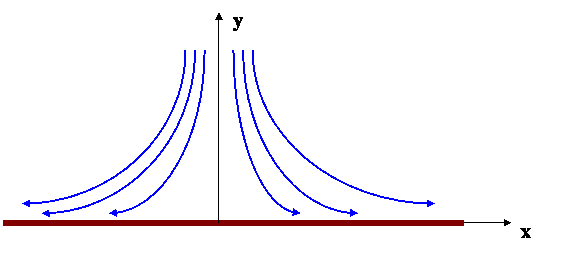

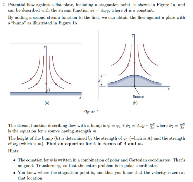

The left image is essentially what I'm trying to solve. However, here they already give the stream function.
After some time, I'm allowing myself to ask again, since I'm still looking for the solution of this problem.
Most of the explanations I found gives directly the components of the velocity without explaining how they get it or even if this is possible by using the Laplace's equation and the separation of variables method.
The following image is exactly what I'm looking for. However I still have no idea how to get the velocity components.

Are you asking about solving problem #1 as posted? The problem explicitly states that ##x\text{-velocity}=u=Ax## and ##y\text{-velocity}=v=-Ay##.
@renormalize I posted the image as reference. Sorry for the confusion. Basically, I'm trying to find how to get the velocity in post #8 using the Laplace's equation. This is basically my question in post #1.

So you want to solve ##\nabla^2 \phi\left(x,y\right)=0## and get the velocity field ##\vec{u}=\nabla \phi##? Don't insist on a multiplicative separation of variables; instead, consider the additive separation ##\phi\left(x,y\right)\equiv\frac{1}{2}\left(Ax^2+By^2\right)## and insert this into Laplace's equation. What relation do you get between ##A,B\,##? And what do you get for the velocity field ##\vec{u}\,##?
@renormalize By using ##\phi\left(x,y\right)\equiv\frac{1}{2}\left(Ax^2+By^2\right)## I can get the answer that I'm looking for. However, I don't know where this come from. For instance, ##\vec{u}## was given in post #8, which is equivalent to giving ##\phi##, but I don't see how to get it.
