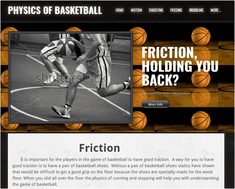

https://leenaphysicsbasketball.weebly.com/friction.html

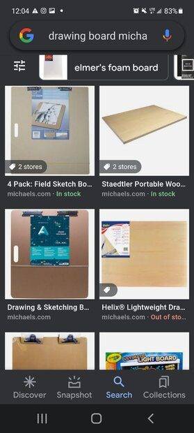

A drawing board is a wooden board, typically with clips at the top and a rubber band near the end, used to hold the paper you are drawing on down.

BTW, in the link I posted there are some tips about how to maximize the friction/traction from BB shoes. Be sure to incorporate those variables into your tests.
Also, an important part of BB is being able to stop quickly and change direction. Does that involve ##F_s## or ##F_d## ?
