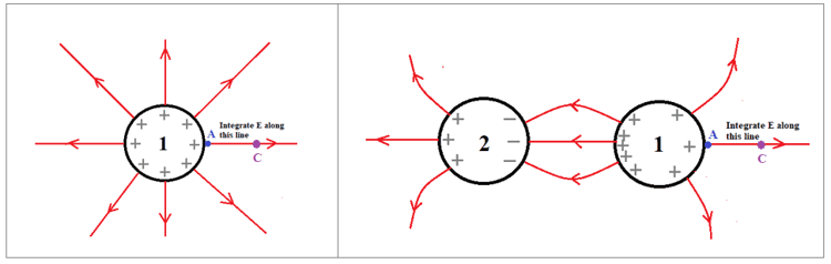

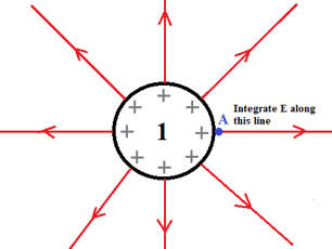

The figure below shows the charged conductor when the uncharged conductor is far away. The potential of the charged conductor can be obtained by integrating E from point A out to infinity.
246670

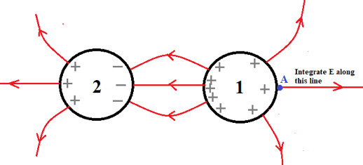

The figure below shows (roughly) the situation when the uncharged conductor is nearby. Consider the magnitude of the E field along the horizontal field line marked with A. How does it compare with the previous figure? How does the potential at A here compare with the potential at A in the figure above?
246671
From consideration of your pictures, I can't conclude anything about spheres potentials. But, I see, the field between spheres become much stronger, so I can conclude, the potential difference become smaller.

I don't see how you get this. When sphere 2 is near sphere 1, the surface charge density on sphere 1will be distributed non-uniformly over the surface of the sphere. As a result, the potential at the surface of 1 due to the charge on 1 will not be ##q_1/R_1##. Also, the potential at the surface of 1 due to the charge ##q_2## will not simply be ##q_2/ \ell##.
Due to the rearrangement of charge on the surface of 1 when 2 is brought near, the electric field along the field line containing point A will be weaker in the second picture compared to the first picture. So, the integral of E along this line from A out to infinity will be less for the second picture. Thus, the potential at A in the second picture is less than the potential at A in the first picture.

the electric field along the line with point A will be weaker in the second picture compared to the first picture.
I do not understand. In diametrally oposite point, say ##B##, the field is stronger (in second picture), so, we can integrate ##\int\limits_{B \to \infty} \vec{E}\cdot d\vec{r}## (through 2nd sphere).
Yes, in principle you could start in the second picture at ##B## (which is diametrically opposite to ##A##) and integrate ##E## along a horizontal line from ##B##, through sphere 2, and on out to infinity. You would necessarily get the same result as starting at ##A## and integrating out to infinity. But, the advantage of starting at ##A## is that it is easy to compare with starting at ##A## in the first picture.

Yes, integrating alohg ##B \to\infty## and ##A \to\infty## must give the same result. That is, we start from points with the same potential but with different values of the field and we get the same result. Therefore, it seems to me that the reasoning by analyzing the density of the lines of the field is not entirely strict. But, most likely, you are right.
Let ##C## be any point on the horizontal line to the right of sphere 1. I think it is fairly intuitive that the field at ##C## in the second picture is weaker than the field at ##C## in the first picture.
246718
Admittedly, this is not rigorous. It is possible to construct a more rigorous argument.
