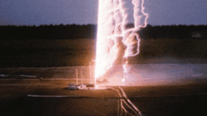

The title of the video said storm, so my guess is just plain old wind.
My firm used to do rocket triggered lightning experiments as shown in the picture. The parallel paths in the picture are repeated strokes. The total time duration is probably 0.3 seconds. The mechanism of horizontal movement is simply a trail of ionized air being blown by the wind.
In the case of the video below, we have continuous arc rather than separate strokes, but still there is a patch of ionized air being blown by the wind. Some of the ions get left behind, but new ones are created each instant.
In this video at 2:53-3:04 ask yourself why this arc wants to move to the left and why a long U rather than a shorter one. IMO, it is once again simply wind.

I'm not convinced. The arc in the video moved at about 10 m/s (20 knots). The trees had no leaves. 20 knots of wind does not make dramatic visible effects on bare trees. Wind is still my wager.berkeman said:Aint no wind in those trees in the video...![]()
- 1,567
- 5,225
+1anorlunda said:I'm not convinced. The arc in the video moved at about 10 m/s (20 knots). The trees had no leaves. 20 knots of wind does not make dramatic visible effects on bare trees. Wind is still my wager.
https://www.kxan.com/news/stunning-...surge-traveling-down-power-line-during-storm/
The winter storm moving through the area is the same as the one knocking out power to cities in Texas and dropping snow from the Gulf of Mexico to the Ohio River Valley.
Easy to see the arc being affected by wind here causing wire slapping.
