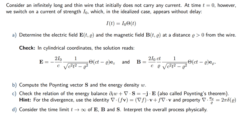

Check the relation of the energy balance ##\partial_t \omega + \nabla \cdot \vec S=- \vec j \cdot \vec E##
none
Hi
I have a problem with task c)
For the Poynting vector ##\vec S## and the energy density ##\omega## I got the following:
$$\vec S= \frac{1}{\mu_0} \frac{4 I_0^2}{c \varrho} \frac{t}{c^2 t^2 - \varrho^2} \Theta(ct-\varrho)^2 \vec{e}_\varrho$$
$$\omega= \frac{1}{2} \epsilon_0 \frac{4 I_0^2 \Theta(ct- \varrho)(\varrho^2+c^4t^2)}{c^4\varrho^2t^2-\varrho^4 c^2}$$
Then I calculated the following
$$\partial_t \omega=\frac{4 I_0^2 \epsilon_0(c^4t^2+\varrho^2)\delta(ct-\varrho)\Theta(ct-\varrho)}{c^3\varrho^2t^2-c\varrho^4}-\frac{4 I_0^2 (c^2+1)t \epsilon_0 \Theta(ct-\varrho)^2}{(c^2t^2-\varrho^2)^2}$$
and the i used the hint ##\nabla (f \vec v)=(\nabla f) \cdot \vec v + f \nabla \cdot \vec v##
$$(\nabla f) \cdot \vec v + f \nabla \cdot \vec v=\Biggl( - \frac{8 I_0 t \delta(ct-\varrho) \Theta(ct-\varrho)}{c^3 \mu t^2 \varrho-c \mu \varrho^3}-\frac{4 I_0 t (c^2t^2-3 \varrho^2)\Theta(ct-\varrho)^2}{c \mu (\varrho^3-c^2 t^2 \varrho)^2} \Biggr) \cdot \vec e_\varrho + \frac{1}{\mu_0} \frac{4 I_0^2}{c \varrho} \frac{t}{c^2 t^2 - \varrho^2} \Theta(ct-\varrho)^2 \cdot \vec e_\varphi$$
Unfortunately I don't know what I can do with it, the results are quite a mess or have I miscalculated and also in the task part b) ?
The relation
[tex]\theta(x)^2=\theta(x)[/tex]
might easen your calculation. In your calculation of
[tex]\omega= \frac{1}{2} \epsilon_0 \frac{4 I_0^2 \Theta(ct- \varrho)(\varrho^2+c^4t^2)}{c^4\varrho^2t^2-\varrho^4 c^2}[/tex]
I find ##\varrho^2+c^4t^2## is strange in dimension.

With ##\Theta(x)^2=\Theta(x)## the term now looks like this:
$$\partial_t \omega=\frac{2 I_0^2 \epsilon_0(c^4t^2+\varrho^2)\delta(ct-\varrho)}{c^3\varrho^2t^2-c\varrho^4}-\frac{4 I_0^2 (c^2+1)t \epsilon_0 \Theta(ct-\varrho)}{(c^2t^2-\varrho^2)^2}$$
Unfortunately, I still can't get any further with this term and I have recalculated and again get the term ##\varrho^2+c^4t^2## for ##\omega##
You clearly have an algebra error. The term ##\varrho^2+c^4t^2## is dimensionally inconsistent because ##\varrho\sim L,c\sim\frac{L}T{},t\sim T##.
The problem statement expresses the fields in Gaussian units. In these units the Poynting vector is ##\mathbf S = \dfrac {c}{4 \pi} \mathbf E \times \mathbf B## and the energy density is ##w = \dfrac{1}{8\pi}(E^2 + B^2)##.
Using the expressions for the fields given in the problem I find $$\mathbf S = \left[ \frac{I_0^2}{\pi} \frac{t}{c^2t^2 - \rho^2} \theta(ct-\rho) \right] \left(\frac{\hat e_{\rho}}{\rho} \right).$$ This is the same as your result except for differences in the constants. I could have made mistakes, so you can see whether or not you can get the same expression. The reason for writing the last factor as ##\dfrac{\hat e_{\rho}}{\rho}## is to prepare for using the divergence identity given in the problem statement.
The problem statement says ##\nabla \cdot \left( \dfrac{\hat e_{\rho}}{\rho} \right) = 2\pi \delta(\rho)##. Actually, this should be ##\nabla \cdot \left( \dfrac{\hat e_{\rho}}{\rho} \right) = 2\pi \delta^{(2)} (\boldsymbol {\rho})##, where the right side is the two-dimensional delta function ##\delta^{(2)} (\boldsymbol {\rho})## and ##\boldsymbol {\rho}## is the two-dimensional position vector for points in a plane perpendicular to the z-axis. The dimension of ##\delta(\rho)## is inverse length; whereas, the dimension of ##\delta^{(2)} (\boldsymbol {\rho})## is inverse area.
##\delta^{(2)} (\boldsymbol {\rho})## is useful for expressing the current density for this problem: $$\mathbf J(\boldsymbol {\rho}, t) = I(t)\delta^{(2)} (\boldsymbol {\rho}) \hat e_z$$

I have repeated the calculation again with Gaussian units and get the same result for the Poynting vector
:smile:
You were right, instead of ##\nabla \cdot \left( \dfrac{\hat e_{\rho}}{\rho} \right) = 2\pi \delta(\rho)## it should be ##\nabla \cdot \left( \dfrac{\hat e_{\rho}}{\rho} \right) = 2\pi \delta^{(2)} (\boldsymbol {\rho})##. But my lecturer wrote it as ##\nabla \cdot \left( \dfrac{\hat e_{\rho}}{\rho} \right) = 2\pi \delta(x) \delta(y)##
