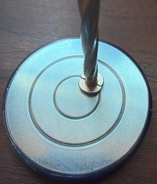

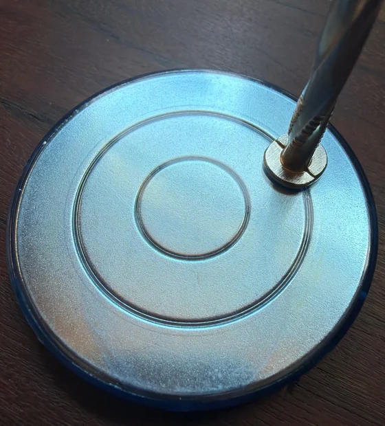

I was experimenting with multipolar permanent magnets (concentric alternating-polarity) and a nail and noticed something that initially seems counterintuitive.
Using a handheld gauss meter, when scanning normal to the magnet face (z-axis), the measured Bz is maximal near the centre of the magnet (furthest from the alternating pole) and approaches zero at the boundaries between adjacent poles, as expected due to axial cancellation.
However, when placing a small ferromagnetic object (e.g. a steel nail) over the magnet:
• With the flat end facing the magnet, the object consistently snaps to the interpole boundaries, precisely where Bz ≈ 0
• When the nail is flipped and the sharp tip faces the magnet, it preferentially aligns over the centre, where Bz is maximal
Photo of a nail standing upright with its flat head against a circular magnet with two concentric ring grooves, on a wooden surface.
Photo of a steel nail standing upright on a concentric circular magnet, with a ring-shaped groove pattern visible on the magnet face.
Photo of a steel drill bit with its pointed tip resting on the centre of a circular magnet with concentric raised rings, on a wooden surface.
This suggests that the attractive force is dominated by field gradients rather than local field magnitude, and that object geometry (flat or point) strongly influences which part of the field is sampled.

How do you know that the nail is not magnetised in some weird way?
Correct. If the B field is constant in a region enclosing a ferrous object, there is no net magnetic force on the object. There is a mild gradient heading axially away from a cylindrical magnet, which will attract an object like a nail. But there is a stronger gradient side-to-side between the coaxial alternating poles for that magnet that you show, which is why the flat head is strongly attracted to that region.

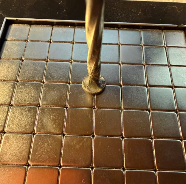

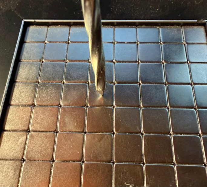

It could have been explained better, I agree. The magnets in the photo are static magnets and the interpole boundary is the neutral line between two neighboring opposite-polarity rings. Just like the images below, where the interpole boundary is the neutral line between two neighboring opposite-polarity squares. You see the same effect. The point of the nail is attracted to the centre of the magnet, where Bz in max, while the flat part of the head of the nail is attracted to the point where B(dx/dy) gradient is maximum. I was expecting both ends of the nail to be attracted to same spot.

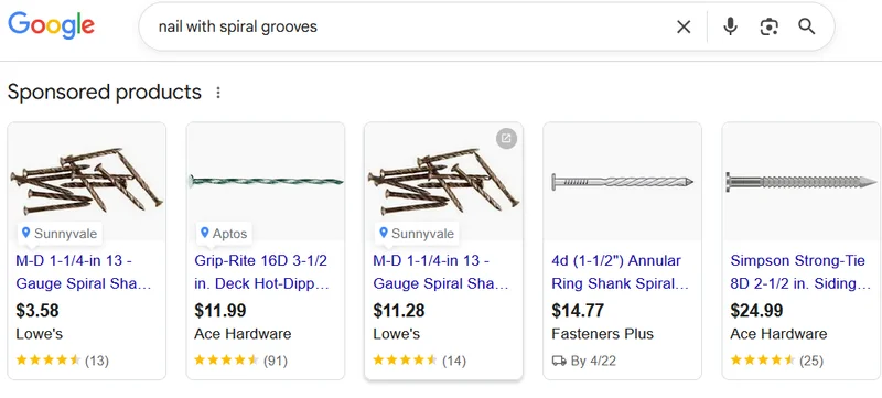

It looks like they are called "Spiral Shank Nails", and the grooves afford superior holding power for the nails:
Google Shopping results for the search 'nail with spiral grooves', showing five sponsored product listings with prices and store names for spiral shank nails and a ring shank spiral nail.
I don't think the spiral grooves are affecting this experiment. It's just that the B-field gradient experienced by the flat head of the nail is stronger side-to-side given the dimensions of the nail head versus the forces experienced by the nail when the pointed end is down. I don't find it all that strange overall.

It is starting to make a little more sense, now that I have a clearer picture of it. I think the flat head is extensive enough that it is able to get magnetized in the x-y plane with a north pole and a south pole that will line up with the south and north poles respectively of the underlying magnet.
For the case of the point, the nail can get magnetized in the z direction, and if the point is above a north pole of the underlying magnet, a south pole will appear at its tip, etc., with the north pole at its head.
That makes sense. Thanks for that. The image from OP there are three alternating poles, with the two ring magnets and one central disc.
A nice one-sentence explanation would be:
The point behaves like a flux concentrator that seeks the centre of a single pole cell, while the head behaves like a keeper that seeks to bridge adjacent opposite poles, so it settles over the four-pole junction.
