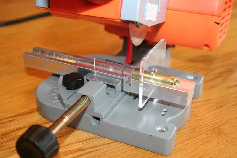

I need to make a lot of precision cuts in brass tubing for a project I'm working on. I'm using a Dremel with a cutoff wheel and a vise. The Dremel is strapped to my workstation via a set of wooden tracks so it can slide to and fro, enabling me to cut the tubing in the vise.
It's not accurate enough. I need sub-millimeter precision.
I am considering re-making a jig using metal tracks so it's more rigid, but the effort may be prohibitive, since I'd need ways of securing and releasing it, and that adds complexity.
My question is: does something similar exist (or something I can adapt)? I'm happy to start with a base and modify it as-needed. I'd Google it, but I'm not even sure what I might call it, except "jig".

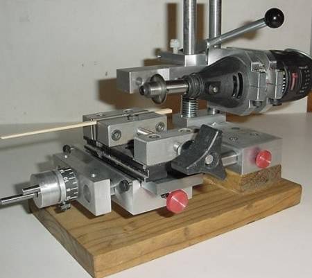

Fine engraving or machining is often done using a pantograph arrangement. The pattern can easily be ten times larger than the object being machined. I have one pantograph here that is used to engrave the surface of small circular cylinders from much larger patterns. The pattern and the work are mounted at different ends of the same shaft. The cutter is controlled by the follower through the adjustable ratio pantograph. google 'pantograph' for many possibilities.

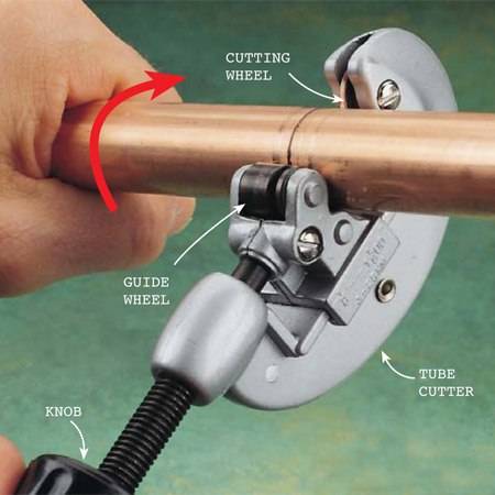

Is there a reason you are using a Dremmel tool cutoff wheel instead of a traditional plumber's copper pipe cutter?
Perhaps you missed where he said he is looking for sub-millimeter precision. Hard to think you could get that w/ a pipe cutter.

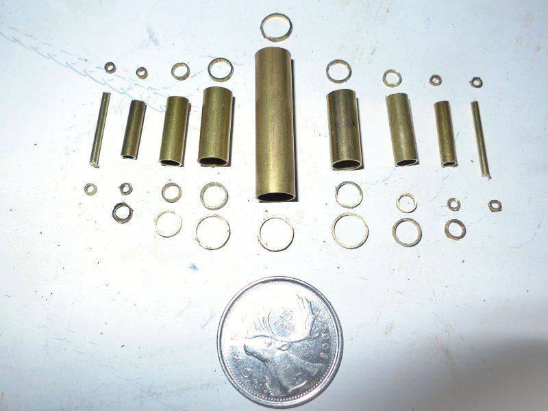

I am cutting 12" stock hollow brass tubing (from a hobby shop) between 1mm and 10mm in diameter.
I want to cut lengths between 1mm and 40mm. It is these 1mm lengths (one might call the final product a ring) where I have trouble with my homemade jig. Even a small amount of play gives me lousy raggedy-edged pieces that I have to spend precious time grinding to a flat end.
I misrepresented the sub-millimeter accuracy. It's not that it needs to be accurate - it just needs to be steady. (i.e. my 1mm rings could be 1.2mm, no big deal, but they need to have a clean, flush, flat cut, not ragged).

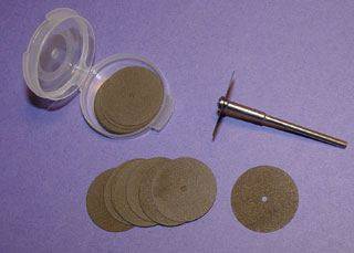

You didn't mention which kind of cut-off wheel you use.
I've been using the standard ceramic cutoff wheels.

I assume that you mean the K7 style that uses a fibreglass disk.
No. What's that?

Have you looked at Incra jigs?
Not yet. Thanks.

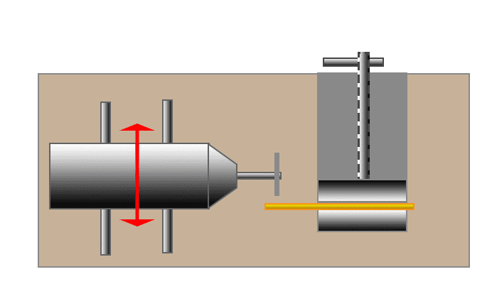

Machining principles suggest that you should avoid sliding the cutting disk across the tube. Instead, rotate the tube. If the tube rests in a 'V' it can held in place and rotated by hand. The position of the tube can be controlled by the flat end of a square bar that also rests in the 'V'. The cutter then has two positions, firstly; clear above the tube and secondly; cutting the first mm into the tube. The tube is then rotated in the 'V' while being held against the square stop until the part between the cutting disk and the stop is separated. The process can then be repeated if needed with the same setting. By having a 10 mm AF square bar as the stop, rings of all sizes will be cut square. Careful control of pressure against the stop at the end of the cut will keep the end of the stock tube square, ready for the next ring.
Baluncore, I'm missing how your method feeds the next section to be cut, over and over, providing the consistency in length that Dave needs.

One problem here, is that my stock material is between 1 and 12" long. To put a stop on the end of both a fresh piece and an almost-finished piece would require a stop-movement of at least 12". This is one of the reasons why I chose to clamp the stock - then it can be any length.
No, my stock would now be shorter. I'd move the stop in a millimeter, or whatever. That's not a problem.
It is however one of the reasons why I want to ensure that unlocking-moving-locking the stop is convenient (ideally without having to shut off the Dremel, and ideally without losing a finger).Cool. So, I can see the setup taking shape, and it is pretty simple. A 12" groove with a stop, The Dremel clamped to the table.
The only component left is giving the Dremel some up/down freedom to engage/disengage the material. And the material has different diameters, so it would need to be lockable at a fixed distance from centreline (centre of rotation for tube). (i.e. to cut 10mm tube, it would be fixed with wheel ~5mm from centreline, to cut 4 mm tube it would need to be virtually 0mm from centreline)
Maybe not clearly explained. I think you have reversed my suggestion.
The distance between the stop and the cutting disk sets the thickness of the unit being cut. You hold the unused stock, where necessary with some form of extension such as a wooden dowel or the next stock soldered to the short end.
The positions along the V bed are; Adjustable stop, unit being cut, cutting disk, remaining available stock held by hand beyond the V bed.
Okay, there has to be some sort of communications gap happening here. I thought that you had the Dremel under control and just were looking for a way to stabilize the tubing. That's why I recommended using a drill chuck, which can be still attached to the drill and strapped down. Now you say that you already have a drill bolted down. If so, what else do you want to hold? And why would you use a V-notch to hold the drill? This is all very puzzling.

Those look like 409's to me, which are emery rather than ceramic. The 420's are also emery, but 15/16" in diameter. I've used 409's, and avoid them whenever possible except for polishing stuff with the faces of them. They flex in use, like spinning pizza dough, and shatter into pie-type shards if they encounter anything that they don't like or are fed in even the tiniest bit too quickly (which binds them; at 30,000 rpm, that's an easy slip to make). I'd maybe use one to cut light plastic, but certainly nothing made of metal.
I see.
There's a problem there though. The Dremel's cutting wheel is a smaller diameter than the Dremel's body. Which means it cannot lie next to the remaining stock. (see top diagram in attachment)
I guess I can flip the Dremel, but it means the stop will have to lie next to the Dremel chuck and that will limit the longest piece I can cut.
BTW, I don;t know how the Dremel would rest in the V-groove and still be in the right cutting position. Gotta be separate units, secured to a base, methinks.
And I still need a way to engage/disengage the wheel from the tubing. So the Dremel has to slide sideways a little bit. And accurately, so I don't have the same old problem as when holding it by hand.

They (409's) most definitely flex excessively while cutting. That's why they're so easy to bind if over-fed. And you have to run at close to max rpm's to get anything done; they won't cut wax at low speed.
I can't give you an endurance estimate for 426's, since I've never used them on anything soft. They were reserved for stuff that bolt cutters or hacksaws couldn't do because they're a bit pricey. The trick to a Dremel, as I'm sure you know, is to keep the speed up and the pressure down. With a light touch at 30,000 rpm, it would take maybe 1/2—3/4 of a wheel to cut through the 5/16" shackle on a standard-duty padlock. Taking pauses to let things cool down extends that life. Also, effectiveness diminishes with wear, since the rim (cutting edge) speed at the same rpm is related to the diameter, and the loss of diameter accelerates. Off the top of my head, I'd guess that you could do at least 400—500 cuts through your 10mm brass tubing. According to my trusty dial mike, the thickness varies from .045" to .052"... so let's just call it 1mm.
