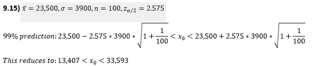

Here is my attempt at a solution:
Handwritten worked prediction interval: x-bar = 23,500, sigma = 3900, n = 100, z = 2.575; 99% prediction bounds 23,500 minus and plus 2.575 times 3900 times sqrt(1 + 1/100), reducing to 13,407 < x0 < 33,593.
However, the book has the bounds as (13,075, 33,925).
I also considered trying a t-value instead of z-value, but...
a) the book uses z-values for problems like this
b) the book never, ever asks for a t-value with n > 30
c) the t-value I do get if I try it that way doesn't work anyway.
I did this backwards based on the book's answer. With an interval of 10425, standard deviation of 3900, and n=100, the z/t value you would need is 2.66 - this doesn't work as a z-value, and as a t-value it would only work with a sample size of 60 or so. Please help, I'm lost!

The value of ##z_{\alpha/2} ## is closer to 2.576 than to your 2.575, so the computed interval should be very slightly larger than yours (13,404 → 33,596). Furthermore, in this problem the t and the z are noticeably different (##t_{\alpha/2}(99) = 2.626##), so that gives a still wider interval, but still not as wide as that in the book.
I don't think you made a substantial error, so I would say that the book's answer is wrong. That type of issue is unfortunate, but is not uncommon.

Ok. I was kinda wondering if maybe the book was wrong in this case. Thanks for your reply!
