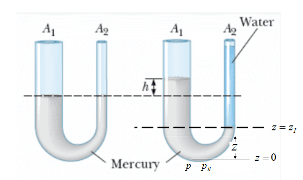

Mercury is poured into a U-tube as shown in Figure a. The left arm of the tube has cross-sectional area A1 of 11.0 cm2, and the right arm has a cross-sectional area A2 of 4.60 cm2. One hundred grams of water are then poured into the right arm as shown in Figure b.
The length of the column of water is 21.7 cm.
Given that the density of mercury is 13.6 g/cm3, what distance h does the mercury rise in the left arm?
V1 = V2
P = P0 + pgh
I honestly have no clue where to start. Finding the length of the column of water was easy, but I don't really know what to do from here.
let h' be the height of the water above the dotted line. Pressure at the dotted line is the same on both sides of the tube so we know that: ρmercurygh = ρwatergh'
We also know the volume of mercury above the line is the same as the volume of water below the line so we can express h in terms of h', L (length of water column) A1 and A2. then substitute in the first equation and solve for h.
I don't think that this is correct. In figure B, the pressures are the same in both tubes only at the level of the water-mercury interface in the right hand tube, (and below). This equation is correct for figure B only if the dotted line were moved to the level of the water-mercury interface in the figure.

let hb be the height from the water-mercury interface to the dotted line. Pressure at this level is the same on both sides of the tube so we know that: ρmercuryg(h + hb) = ρwatergL (where L is the length of the water column)
We also know the volume of mercury above the dotted line is the same as the volume of water below that line so we can express hb in terms of h, A1 and A2. then substitute in the first equation and solve for h.

Clearly I'm lacking some sort of basic concept here. Why is pressure the same on both sides at that level? Also, what level would that be on the left? Obviously you mean the level on the right where the mercury and water meet, but on the left side what level does that correspond to? The surface of the mercury above the line or some imaginary line at that same exact height (I'd assume it's the former)?

The pressure in a fluid is the same at all points with same elevation, which is what P = ρgh states mathematically.
My mistake in #2 was ignoring that there were two different fluids (with different densities).
The same elevation, so, it's a horizontal line.

Let's take a step back. Imagine (or actually draw) a second horizontal dashed line across the U tube at the level of the interface between the mercury and the water in the right arm. Beneath this dashed line is only mercury in both arms. I think we can all agree that the highest pressure in the system is going to be at the very bottom of the U tube. Call this elevation z = 0, and call the pressure at this location ##p_B##. Now consider the pressure in either arm at an elevation z that is less than the elevation of the interface ##z_I##. In the right arm at elevation z, the pressure will be ##p =p_B-\rho_mgz##, where ##\rho_m## is the density of mercury. What would be the pressure in the left arm at elevation z?

No. It would be the pressure at arbitrary elevation ##0\leq z\leq z_I##. The difference in pressure between the lowest point and the elevation ##z_I## would be ##p(z_I)-p_B=-\rho_m g z_I##, and the difference in pressure between the lowest point and the arbitrary elevation ##0\leq z\leq z_I## would be ##p(z)-p_B=-\rho_m g z##.
Can you see why the pressure in the left arm at elevation ##0\leq z\leq z_I## would be exactly the same as the pressure in the right arm at elevation ##0\leq z\leq z_I##?

So, now we're in agreement that the pressures in the two arms of the U tube at the elevation ##z=z_I## (i.e., at the interface in the right arm) are equal, with the value equal to ##p(z_I)##. We obtained this result by working our way up from the bottom of the U to elevation ##z=z_I##.
Now, we are going to go in the reverse direction by working our way down from the top. Let
##h_w## equal the height of the water column in the right arm above elevation ##z_I##
##h_m## equal the height of the mercury column in the left arm above elevation ##z_I##
##p_a## = atmospheric pressure prevailing at the top of both columns
So, in the right column, the pressure at elevation ##z_I##, ##p(z_I)##, will be given by:
$$p(z_I)=p_a+\rho_w g h_w$$where ##\rho_w## is the density of the water.
By this same rationale, what would be the equation for the pressure at elevation ##z_I##, ##p(z_I)## in the left column?
I think it would be $$p(z_I)=p_a+ρ_mg(h+h_2)$$
h being the given height in the diagram that we're trying to find, and h2 being the height between the two dotted lines, right?
Yes, that is correct. What do you think should be done next?

I think you could compare the volumes, so that V1 = V2? Not sure if that would be right. If it's true, you could do A1(h+h2) = A2(height of water)

You have to set the left arm pressure equal to the right arm pressure at the lower dotted line. That is, you have to set the pressures in our last two equations equal to one another. This gives you an equation for ##h+h_2## in terms of ##h_w## (i.e., your 21.7 cm of water). So, you now have an algebraic equation involving the two unknowns h and h2. You need another equation.
In figure B, in terms of h, what is the volume of mercury above the upper dotted line? In terms of ##h_w## and ##h_2##, what is the volume of water above the upper dotted line? The sum of these two volumes must be 100 cc, the total volume of water added. What do you get when you add these two volumes and set them equal to 100? This gives you your second algebraic equation involving the two unknowns h and h2.

Okay, so from that equation, the P's cancel out because at the surface they have atmospheric pressure. Solving for h+h2, I get that h+h2=1.5956 cm.
In terms of h, the volume of mercury above the dotted line would be A1h. Not sure what the volume of water above the dotted line would be.

The height of the water column above the dotted line is ##h_w-h_2##.
