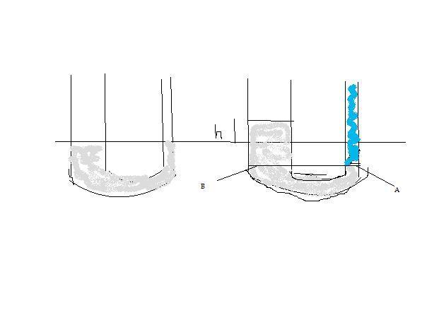

Mercury is poured into a U-tube. The left arm has a cross-sectional area A1=.001 m and the right has A2=.0005m. One hundred grams of water are then poured into the right arm. Determine the length of the water column in the right arm of the U-tube; given the density of mercury is 13.6 g/cm^3, what distance h does the mercury rise in the left arm?
Just volumes of cylinder and pressure variations with depth:
[tex]P=P_o + ρgh[/tex]
I’m not sure how to deal with this problem. I found the height in the column fairly easily since we know the density and mass and cross sectional area, it’s pretty easy to solve for h of the water column, it is .2 meters.
I’m not sure how to set up equations to solve for the distance the mercury has risen though. I don’t know how to apply the principles of static fluids here since there are two different types of fluid.
Pressures are not equal at equal heights I presume. Both surfaces of the water and the mercury must be at the same pressure, atmospheric pressure, yet are at different heights.
However I do think the pressures at points A and B (labeled in the crude scetch) are equal because below the horizontal line I draw there is only mercury.

Hi AdkinsJr! :smile:
AdkinsJr said:
Both surfaces of the water and the mercury must be at the same pressure, atmospheric pressure …
that's right! :smile:
now combine that with :wink:
(or alternatively, the principle that if you start at the bottom, and deduce the pressure at the top of each tube, they have to come out the same)
Ok; I think I'm making progress here. I just need to create another length "d" in the drawing and express the height of the mercury column as a sum h+d...
[tex]P_A=P_B[/tex]
[tex]P_A=P_{atm}+ρ_{h_2O}g(.2 m)[/tex]
[tex]P_B=P_{atm}+ρ_{Hg}g(h+d)[/tex]
The three equations above give:
[tex]ρ_{h_2O}(.2 m )=ρ_{Hg}(h+d)[/tex]
So the 2 unknowns are h and d. So if I just come up with another equation with them it should get things moving.
I think the weights of the columns have to be equal (above B for the mercury and above A for the water). So the mass of the mercury above the point B should be the same as the mass of the water poured in. I have the mass and the density, and thus the volume of mercury above B... which I can write as:
[tex]V=(h+d)A_1[/tex]
Since the areas are given I think this should work; two equations two unknowns.

Actually I think I'm wrong about the weights; they shouldn't be equal because of that principal of the hydraulic press...different cross sectional areas.
The pressures are equal, so I'll have to say that F1/A1=F2/A2 and this should give the mass of the mercury column. Then I can find that volume and use V=(h+d)A1
that looks better! :smile:
