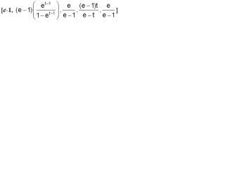

Let the probability function of X be given by
f(x)= c e-x, x=1,2,3,...
(a)Find the value of c.
(b) Find the moment generating function of X,
Solutions (a) e-1
(b) (e-1) [ (et-1)/(1-et-1)]
Can anyone shows the steps?

Solutions (a) e-1
I got [tex]C = \frac{1}{1 - e^{-1}}[/tex]
Is that the same thing?.
I got [tex]\frac{C}{ 1 - e^{t-1}}[/tex]

the whole question is as follow
f (x) = ce-x , x = 1, 2, 3, ….
(a) Find the value of c.
(b) Find the moment generating function of X.
(c) Use the result obtained from (b) to find E(X).
(d) Find the probability generating function of X.
(e) Verify that E(X) obtained using probability generating function is same as in (c).
Answers:
Perhaps there is a typographical error in the problem. Perhaps there is more than one typographical error.
