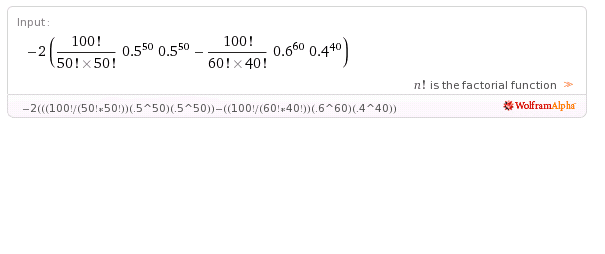

I know that in order to solve for the likelihood-ratio statistic and compare it to chi-square (3.84), I must solve for lambda
attempt 1: without log-likelihood
which gives me 0.003, which is much smaller than 3.84, and thus fail to reject, but this doesn't seem right, as the Wald test and Score test both rejected the null hypothesis.
Also, I have no idea where to start on the confidence interval calculation, and the professor just sent me this
Here is the detail. LRS < chisquare_0.05(1) => -1.96 < sqrt(LRS) < 1.96.
In R, generate a sequence of grid point on pi, and evaluate sqrt(LRS)
at each pi, and find the pi values at which sqrt(LRR) = -+1.96.
I suggest you use the formula given after the statement of the problem.
What you did looks like an attempt to compute the liklihood ratio before taking logs. If that was your aim, you make two errors. One error is that the ratio should be a ratio, not a difference. The second error is that you have one term representing an outcome where only 50 women said the new analgesic is better. The liklihood ratio test doesn't involve hypothesizing different data. It only involves hypothesizing a different explanation for the data that was actually observed.
The ratio of the liklihoods is
\frac{ \frac{ 100!}{60! 40!} (0.5)^{60}(0.5)^{40}}{\frac{100!}{60! 40!}(0.6)^{60}(0.4)^{40}}
The factorials "cancel out" in the ratio so the expression becomes:
= \frac{(0.5)^{60}(0.5)^{40}}{ (0.6)^{60} (0.4)^{40} }
= (\frac{0.5}{0.6})^{60} (\frac{0.5}{0.4})^{40}
The formula you gave after the problem is based on taking logs of this ratio and multiplying by 2.
For example,
\log( (\frac{0.5}{0.6})^{60} (\frac{0.5}{0.4})^{40}) = \log((\frac{0.5}{0.6})^{60}) + \log((\frac{0.5}{0.4})^{40})
= 60 \log(\frac{0.5}{0.6}) + 40 \log(\frac{0.5}{0.4})
