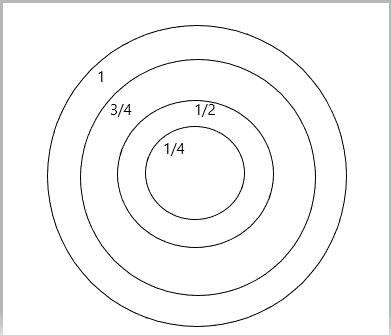

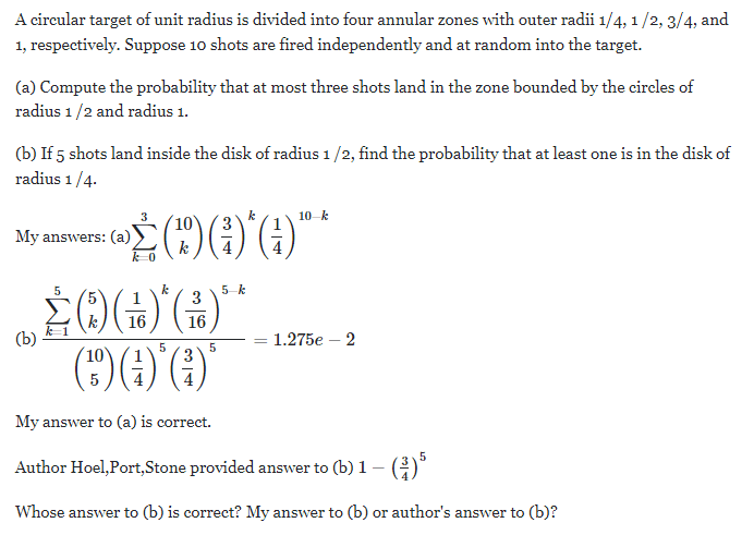

Probability for firing shots independently and at random into the circular target with unit radius.
The book answer to b) is correct. The probability that all five shots land in the outer part of the disk is ##(\frac 3 4)^5##. And the probability that at least one lands in the inner disk is the complement of this.
Please study the figure given below:
1, 3/4 1/2, 1/4 are the radii of the concerned concentric circles.
Yes, I know. It's not to scale, but the answer remains ##1- (\frac 3 4)^5##.
