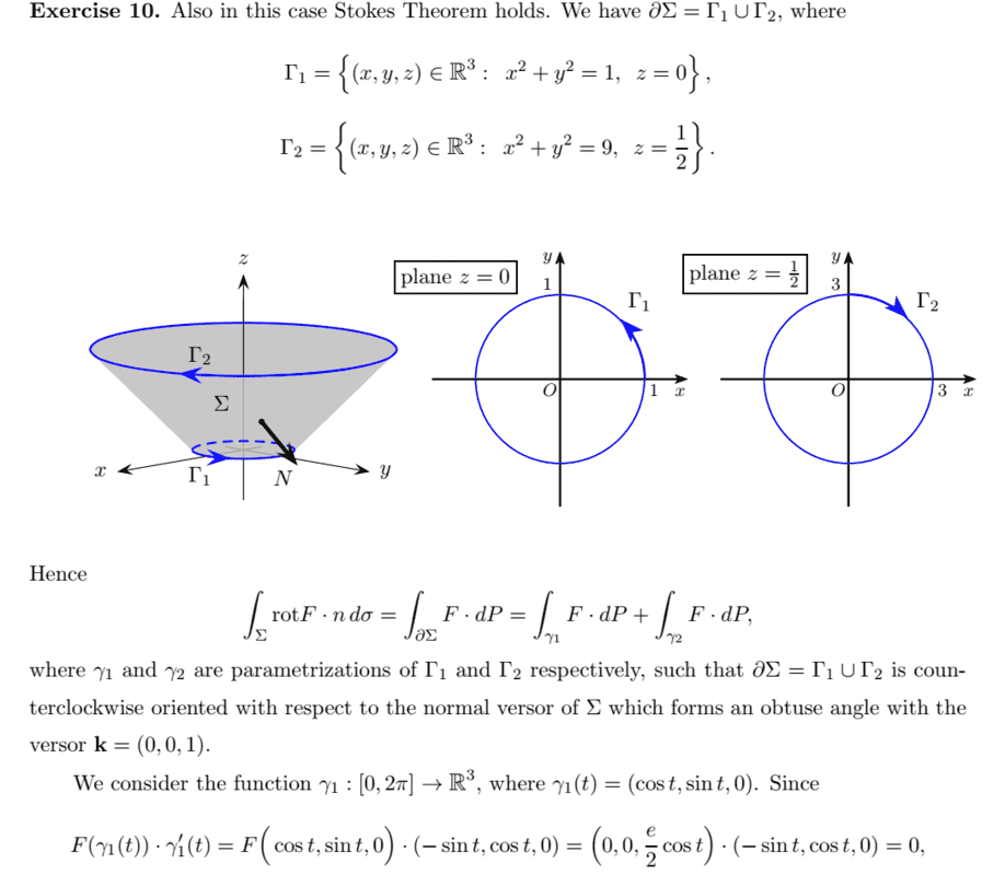

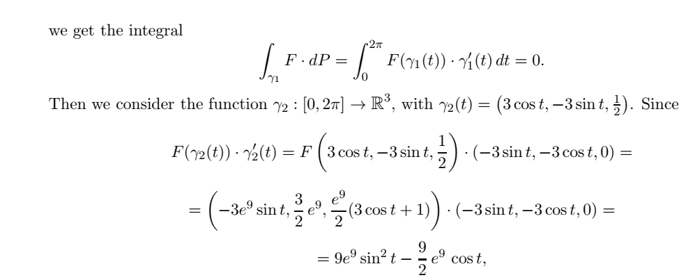

Good day my question is the following:
How did they determine the the orientation of the first and last loop?
and why in the parametrisation of the second loop we have: (3cost;-3 sint;1/2) ( the negative sign puzzles me) thanks
this is the solution of the book
It's a bit tricky to see geometrically. But imagine that cone was much shallower, almost flat. In fact, suppose in the extreme it was flat, and you are looking down on two concentric circles, with the normal pointing away from you (downward), By the right hand rule, the outer circle would be traversed clockwise. Traverse the inner circle you must go the opposite direction. See the attached picture where we imagine a 0 width cut:
The integrals along the cut cancel so are ignored. The rest circulates around the area by the right hand rule. Remember the normal vector is pointing away from you.

thanks a lot I understand now why the outer circle points clockwise (n outward) by wht the inner circle points differently shouldn't be the same?
Imagine the area being actually cut and pulled slightly apart at the cut. Start to go around it. There's no way to walk around it without going the opposite direction on the inner circle. Just follow the arrows.

Thanks a million! and why in the second loop we have: (3cost;-3 sint;1/2) ( the minus sign puzzles me?)
##(\cos t, \sin t )## traverses the unit circle in the xy plane counterclockwise. If you want to go the other way, reverse the parameter, ##t \rightarrow -t##. What does that do to the expression?
