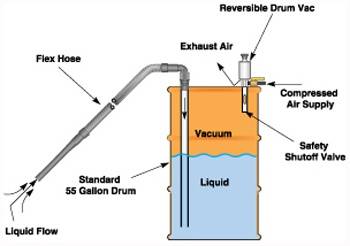

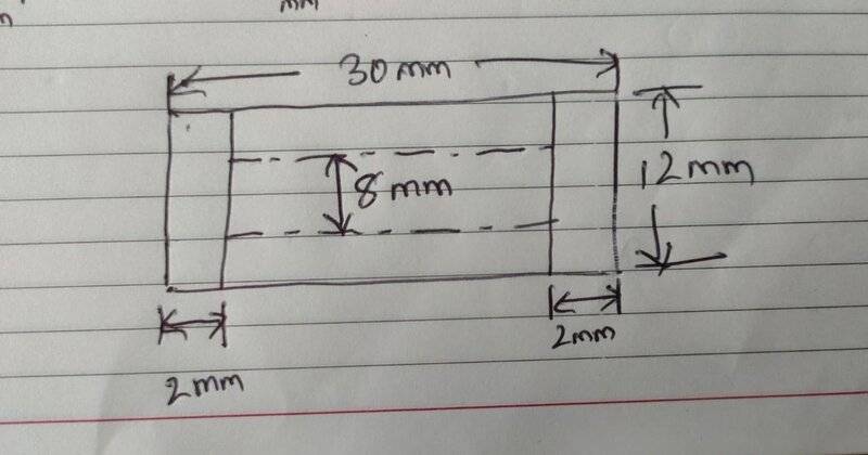

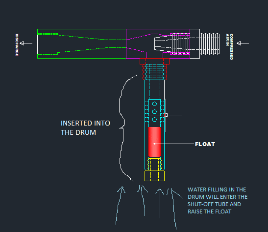

Hey guys, I have built a Compressed air venturi operated Drum Pump for my garage. The system consists of a horizontal venturi tube with a pipe (shut-off tube) that is inserted into the Drum. Turning on the venturi creates vacuum in the drum and thus liquid is sucked from outside and is collected in the drum automatically. This pipe contains a float which moves up-down. Purpose of the float is to block the venturi when the liquid reaches up to the highest level in the drum to prevent overflow of the liquid from the drum. Since it is a purely compressed air operated system, there are no electricals and hence no switches. Attached are photos depicting my system, the float & a standard Exair Drum Vac.
Now, the problem I am facing here is that when I turn on the venturi, the vacuum sucks up the float and blocks the venturi immediately thereby stopping the vacuum generation process in the drum. Releasing the pressure causes the float to fall down in the pipe to its original position and ONLY then the system works (i.e liquid rises and the float rises along with the liquid and blocks the venturi when the drum is full).
The material used for the float is either Nylon/Teflon (don't know which as we have a bunch of either rods available with us) and the shut-off tube is SS304. What can I do to ensure the float ONLY rises up in the pipe along with the liquid? I am worried if I increase the weight of the float, it might not float on water and will remain seated at the bottom of the pipe.

Some things to try:
1) Make the float tube longer so the float is farther away from the venturi.
2) Make a longer float. It will be heavier, so won't get sucked up so easily, but will still float on the liquid.

@jrmichler Thanks for that. Both these suggestions require making a new shut-off tube as I don't have a lot of space to play with in the current one to accommodate a longer float.
I have been speaking to some people and they've asked me to try increasing the size of the holes above the float AND/OR reduce the diameter of the hole under the float (bottom of the shutoff tube). Would appreciate your views on this. Thanks.
More hole area above the float will help. That could be more holes or larger holes.
Reducing the diameter of the hole under the float will help, as will increasing the clearance between the float and the tube.
And you can do all of the above.

Is your compressed air supply just too powerful? The initial Venturi (suck) pressure must not be so great that the air flow round the cut off float lifts its weight. Most of the air will presumably go through the holes in the side of the upper part of the tube (is that what the diagram shows?).
Without help from the suppliers (or the documentation?) you have to do some experimentation.
If you drill and tap a small hole in the bottom of the float and insert a long screw then you can feel - or even measure the available force. If it's only marginally too much then hang a weight under the float - using the screw you already fitted. You say you are short of space but the barrel is massive and you have loads of headroom.
Basically you have to do some experimentation; PF can't think the problem out without some performance measurements. I would try floats of various diameters - the air flow is obviously too constricted at present. Details of the seating of the float into the neck at the top are important. How much smaller could the float be made yet still block the exit?

We increased the number of holes above the float and that has made a visible difference! The float does not get sucked up upon starting the air supply through the venturi.
We've observed another problem though. Some water leaks past the float and enters the venturi which then throws it out along with the compressed air. So I guess we're going to have to change the design of the float & the tube. Will a round float(like a ball) work? Something similar to what you find in an NRV?
The float may not be seating properly. Could there be some grit?
If you insert a U trap between Venturi and the tank valve then fluid leakage can be caught in that.
it sounds like your compressor is too beefy. You could experiment with a tap in series with the HP supply.
I don't know if it's feasible for your design, but:
That's a common problem. If you put a 'fat spot' (low velocity) in the suction line between the valve and the venturi, you can trap out bulk liquid. Float-operated valves almost never 'perfectly' exclude water. If the water is smaller particles, you may need a coalescing filter - it depends on your specific situation. In any case, you want to arrange things so that trapped/precipitated liquids will gravity-drain back to the tank.

Can't help with foam or leaking seals but the premature stoppage is from high differential pressure and high flow rate on initial start. Throttling the valve, allowing the drum to develop some negative pressure before full venturi supply usually avoids this problem. No mods needed.
