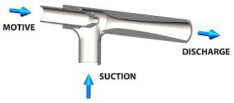

So basically we have designed a Venturi Injector. This was designed by taking some inspiration from existing Venturi designs from the internet. I am in no way an expert on Fluid Mechanics or CFD. The motive liquid in the injector is the Coolant pumped by the Coolant Pump (The unit is connected to the discharge of the pump by a Tee). In the suction port, we have connected a 6mm OD PU Tube and at the other end of the tube is a Suction Block with filters. This block is to be placed on the Chip Trolley. Please see attached file for the drawings.
So in this lockdown, since it is difficult to visit clients, we took trials with our own small pump used for transferring water in our office. We connected the flexible hose from the discharge of the pump into the inlet of the Venturi with a Hose Nipple & Clamp. Our small pump is a 0.5 HP domestic pump that discharges approx. 35 LPM. We placed the Suction Cup into a box with some amount of water.
What we saw was the venturi worked to some extent, as in it sucked the water through the cup, but it would stop sucking liquid after a point. And this happened in multiple trials. We even changed the 6mm OD tube into a 8mm OD tube, but the result was the same. We need the system to reclaim all the water (or coolant). Also we noticed that the outlet of water from the venturi would fluctuate i.e the flow-rate of water kept varying as the suction was taking place. Maybe the flow-rate from the pump is not constant, I need to verify that.
Yes I know I would probably need to take more trials with a bigger pump, but I was wondering if you guys could let me know if I am going wrong anywhere and if there were some immediate changes I can make to achieve this goal. I have filmed one of the trials which can be found on this link - https://photos.app.goo.gl/LLWaS6m3QR4aEqPp6

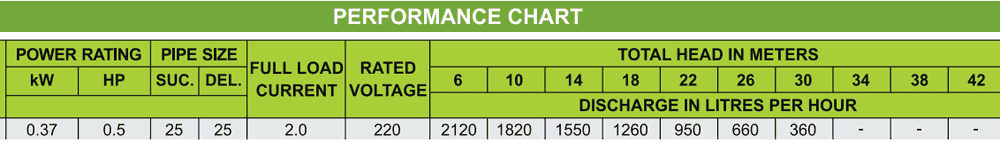

Also, how much pressure is at your pumps output? if the pump output pressure it too high then you won't really achieve a proper vacuum at the venturi throat. For your dimensions of 20mm at inlet and 9mm at throat you only exchange about 40 kPa of pressure for increased velocity at the throat and that's from bare basic bernouilli calculations (calculations that are so basic they are probably wrong). If the pressure at the venturi inlet is too high you simply won't achieve vacuum at the throat. Whatever pump you select will have to match the venturi otherwise you will not have good results.

I don't know the pressure at the pumps output. I have attached the performance chart as per the catalog. It is a small 0.5 HP domestic pump so I am assuming it is not meant for high pressure applications. I will be trying out my unit on actual Coolant pumps in a CNC, but i need to be satisfied with the Venturi during my own trials before I take it to a machine shop.
Finally, I used the cross-sectional view of a venturi I found online during my research as guide. I know it was a shot in the dark, but I never expected this to work even this much. So I guess there's only room for improvement.

Also, I have now realized the diameter of the right side of the nozzle must be higher than the end point of the left nozzle (part where the liquid exits). Attached image FYR. Also, I guess the suction diameter needs to be higher? Any advice on this and anything else will be appreciated. Thanks.

I think your pump is operating of off its intended curve and to the right of it, which might explain some of the erratic behaviour. That means the current pump is oversized and producing more flow than it was intended to.
It is convenient to think of an eductor's motive flow as 'divorced' from the 'suction' flow, but it's also wrong; for low motive pressures, it's extremely wrong. For a liquid-motive eductor, the relationship between motive pressure and motive flow may be very accurately predicted by treating the converging section of the eductor as an orifice, where the downstream pressure is the 'suction' pressure. As you increase the suction pressure (also orifice downstream pressure), the motive flow is reduced (and the motive pressure increases [pump-dependent]). If you're seeing eductor outlet flow variation, this is probably the reason.

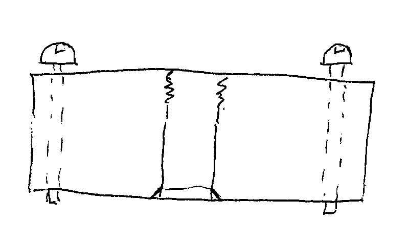

Here's a suggestion. Take a piece of steel heavy enough to stay in place under its own weight, say about 1" or 2" thick by 4" or 5" square or round. Drill and tap for 3 or 4 screws to be used for setting the gap. Drill and tap a center hole for the hose. Add a chamfer to the bottom of the center hole.
Adjust the screws to get the gap that works best.
This is a case where it's quicker and easier to build something and try it than to try to calculate the best possible solution. I mention steel. You could just as well use aluminum, plastic, or even a block of wood. It would just need to be larger in order to be heavy enough to stay in place.

Thanks for this. One query... It appears as if the block would be resting on the screws extending from the bottom. Assuming the height of the block is approx. 28mm & I use 1.25" long screws (31.75mm), the screws would be extending past the block by 3.75mm. Will the venturi produce enough suction to suck the liquid through that gap? And here, the entire block would be resting on something similar to dowel(locating) pins right?
Those screws are adjusted to get the gap that works the best. They should be at least 1.5" or 2" long for a 1" thick block. The block rests on the tips of the screws. You can set the gap to less than 0.1 mm or more than 1 mm. Experiment to find what works best.
